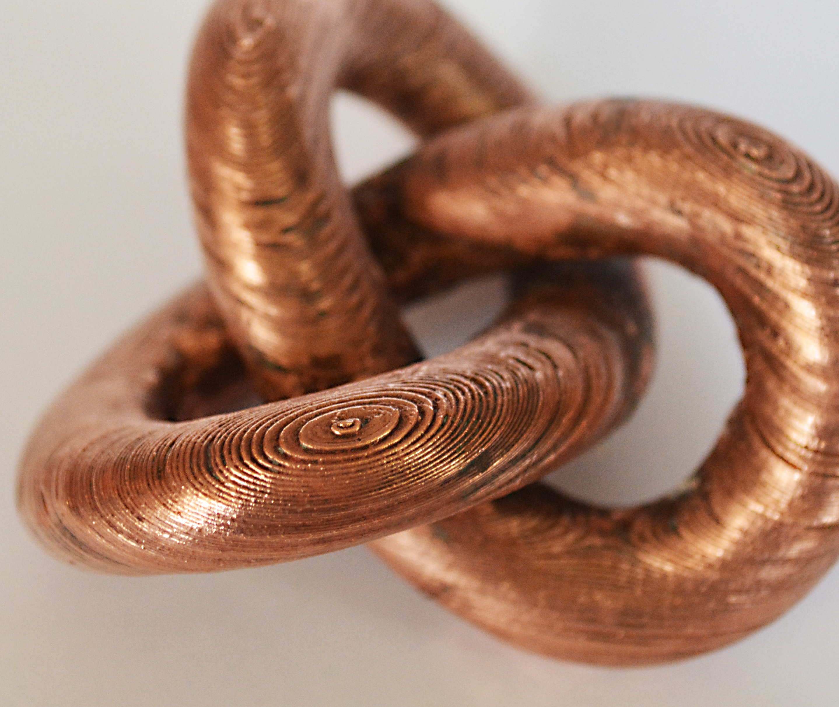

I’ve been electroplating (electroforming) PLA with some very interesting results. I have a bit of an obsession with metal. For years I’ve been using electrolysis as a method of creating metal sculpture. Originally I wanted to sculpt in metal but simply didn’t have access to a foundry. So, I would build things up in various materials (fiberglass, polymer clay, regular clay, etc.) and then give them a nice shiny coat of metal in the plating bath. This kind of turned into a 15+ year pursuit. Then, along came 3D printing. The leap was kind of a no-brainer. My obsession with creating things in metal persists, and as it does I’ll be sharing my various adventures as I document them on my website. The item pictured has a heavy layer of copper. ~.005 inch.
More to come here: http://www.thevirtualfoundry.com/3d-printing
