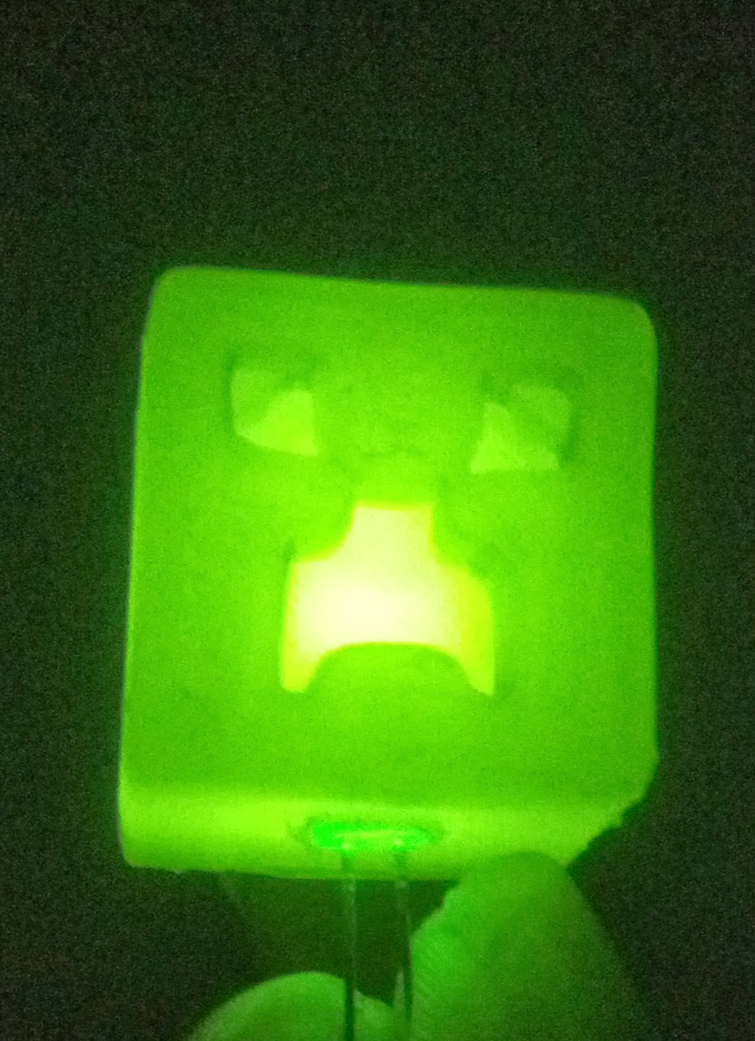

I printed this to experiment with re-homing the X and Y axis after each layer. The concern was that variation in the homing switches would introduce more error than it was worth to prevent an accidental loss of position due to e.g. a sticking filament pulling the print head, or someone bumping the table during printing. As far as I can tell, the re-homing introduced no error on my Printrbot Jr, and since the part was positioned close to home, and is a pretty small part, it cost very little extra time.
And it looks pretty good with a green LED throwee light stuck in it. ,o)
