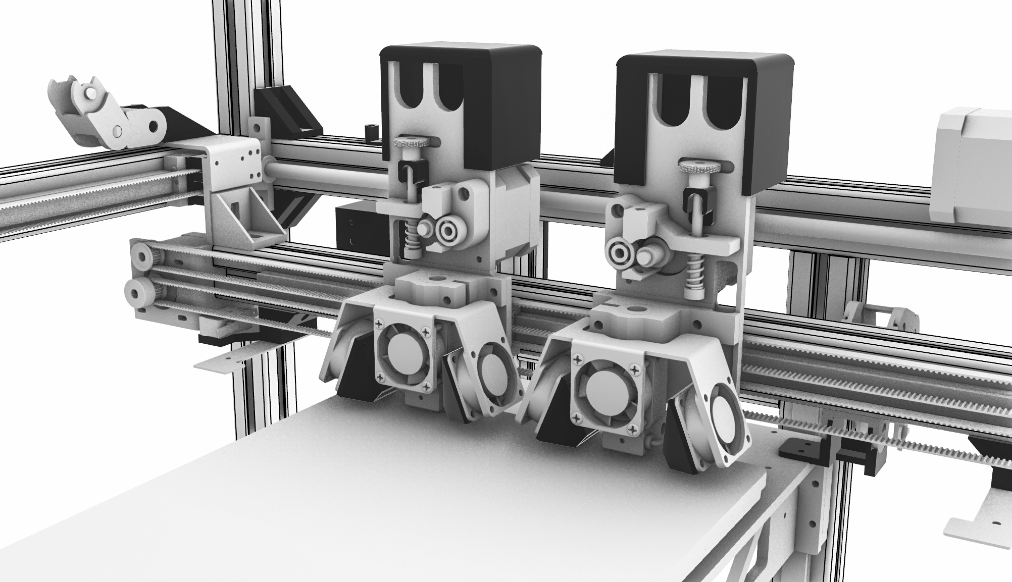

I published my dual-x-carriage 3D printer design.
Pretty cool. I’m working an an IDEX design too. Your extruders look a bit far away from the hotend though, you won’t be able to print flexibles. How much did the entire build set you back?
@Adam_Steinmark Hi. Well i’ve been printing flexibles very reliably for the past 2 years with this extruder. There is a short teflon tube from the drive gear to the extruder. The distance almost couldn’t be shorter for a regular E3Dv6.
The build cost about 1000-1200€
Ah didn’t see the teflon tube. That is pretty cheap with MGN rails and a ballscrew. Do you have a BOM?
