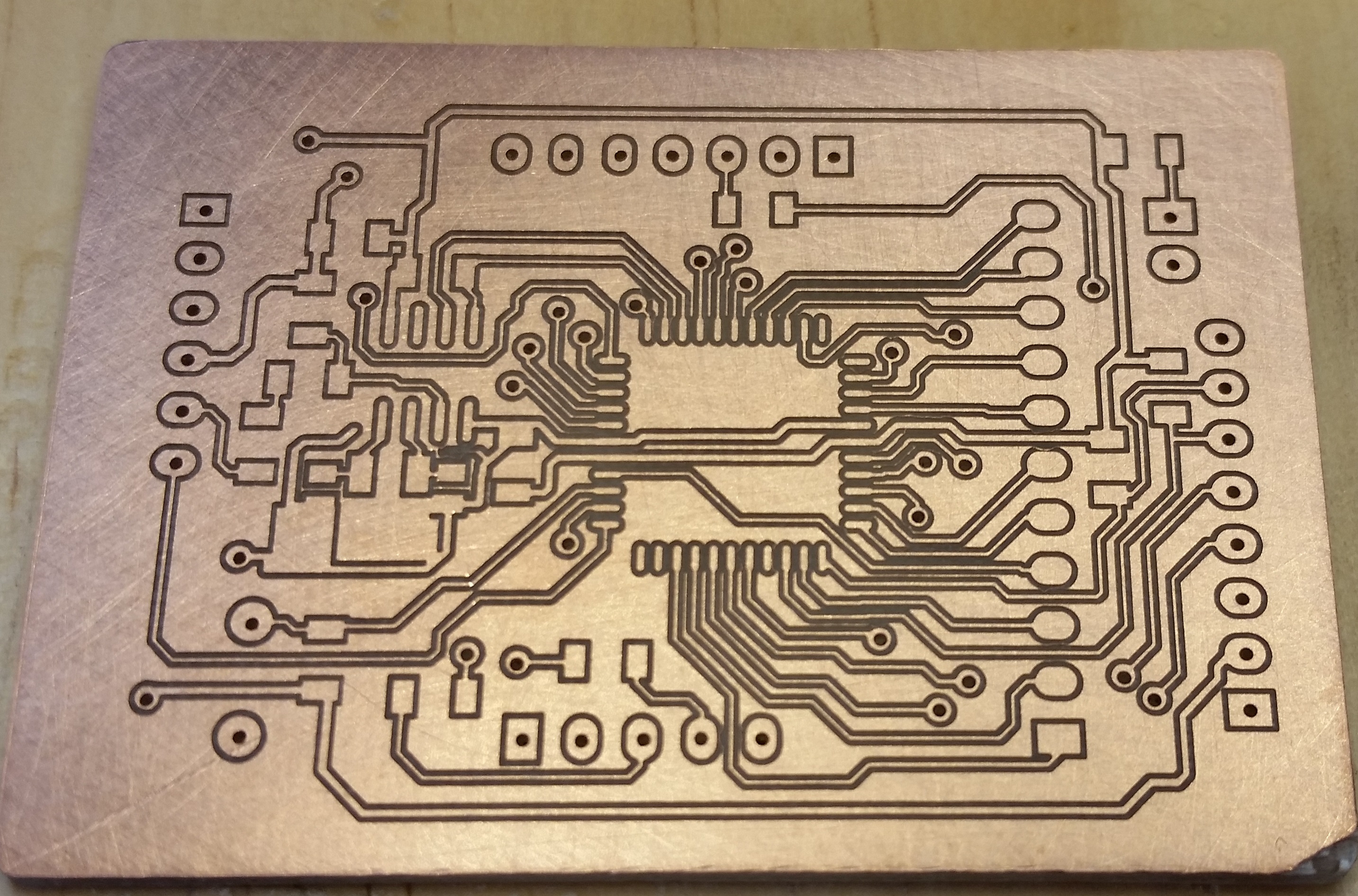

I purchased a cheap milling machine from china $US130 and have since worked through the pcb milling process. The results are quite outstanding thanks to chilipeppr.
Wow. Looks great.
That PCB milling looks quite nice.
I gotta say, for $130, that is a better looking PCB than I’ve seen from any timing belt based machine. Nice work! It does look like the drill holes are not quite centered on some of the pads, but they totally still work. What end mill did you use? Any video of the milling?
Sorry no video.
The end mills are from china too I used cutting depth of 0.08mm at 1mm/s cutting speed. I tried a series of cuts going from 0.1 mm to 0.02 mm in 0.02 mm steps to see what worked. Next time I will try 0.06 mm depth.
It’s look awesome, a very good result. But, please try the spiral engraver endmills, they maybe some $ more expensive but they have a very good cut process and you can better control the cutting depth. Here for an example a german link :
http://cnc-plus.de/de/Gravierstichel/Spiral-Gravierstichel/VHM-Gravierstichel-mit-Spirale--Spiralfoermiger-Fraesstichel.html
Do you have a link to this machine?
Here is the link
Awesome!
Wow! What a nice result for such a cheap machine. I’m getting there, I didn’t test for my first board, just took defaults. I just ordered some spiral bits so I’m going to wait until they get here before doing any more.
I agree with Frank that those v-bits are not good to use. I use these for my finest trace milling http://www.precisebits.com/products/carbidebits/tapered_stub_125.asp
@John_Western did you sand those down afterward? Those v bits always curl up the copper and create a lot of chads and clean up work. So although your 0.06mm looks nice, and that is narrow, when doing a real board with lots of twists and turns I found these bits no good.
Any pics for size reference?
I just read the specs in the link, ,and that’s very tiny unless my conversion was wrong. Approx 3/4" x 3/8" in the XY? Is that right?
Opps, just realised in said cm not mm.
The pcb is about 54mm x 35 mm there is a pic micro in a 44 pin TQFP package in the middle.
I did do a quick sand of the PCB once it was finished.
I will get some spiral end mills and see how they go
