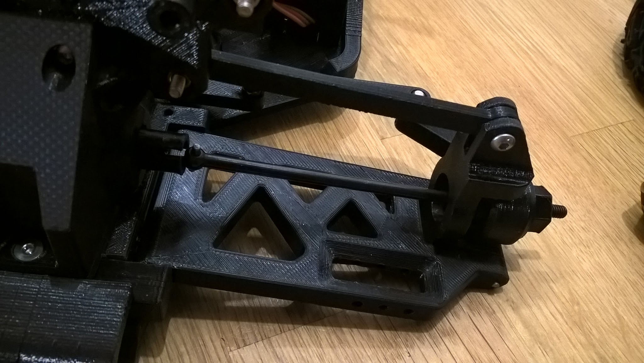

I purchased these CDVs from HobbyKing (PN: 382000124) as recommended by Joshua Updyke but they seem to be short on my build. Anyone know why as no one else seems to have had this problem? I am confused…
I had the same problem, fortunately I have Inventor and was able to create some new shorter parts to fit. My whole build has deviated quite a bit from the original. All my gear boxes are metal which changes things because they aren’t exactly the same size.
You might be able to get away with just shortening one dimension when you print it. Allign the part lengthwise on the X-axis and shorten the size of the printed part on the X-axis in Repetier Host, assuming that’s what you use to print.

He’s talking about his obviously short axles.
From this angle it looks to me that the upper arm is too long. It looks like positive camber.
If so then it is not too strange that the driveshaft is not reaching into the outdrive.
