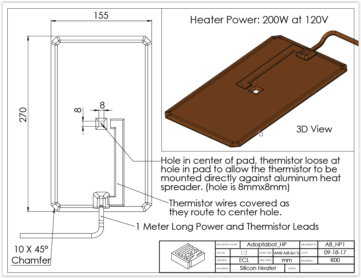

I read something awhile back about Eric suggesting ordering the silicone heater with a hole in it so the thermistor can be replaced. Any ideas how big the hole should be? My idea was 15-20mm, but I’m not sure if that’ll leave enough surface area for the thermistor to stay adhered to the heat spreader
I leave a 25x25mm hole in all my heaters, drill a small divot in the spreader, and place the thermistor in some thermal paste (very small amount). Then secure it to the heat spreader with some polyimide tape
