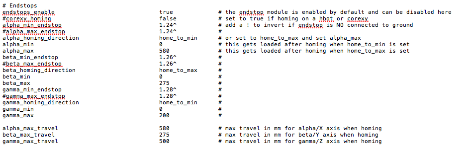

Alright, I got my Y axis sorted out, but I still can’t get my Y Axis end stop to work. I did the usual (swapped plugs, etc) to verify it’s not the stop itself. Can I get someone to look at my config for the endstops to see if I have anything wrong? When I hit “home all axis” the X homes, but the Y does nothing.

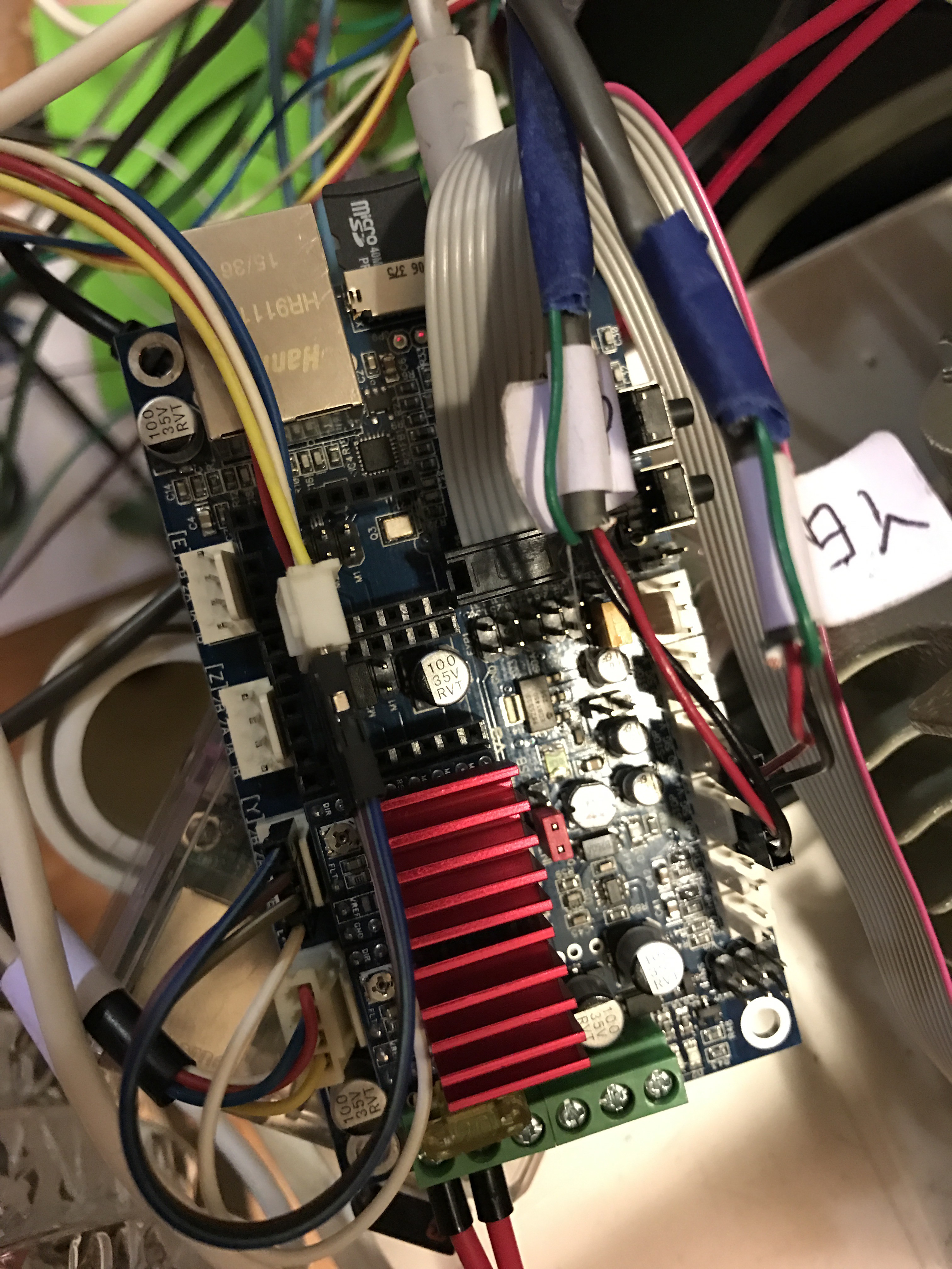

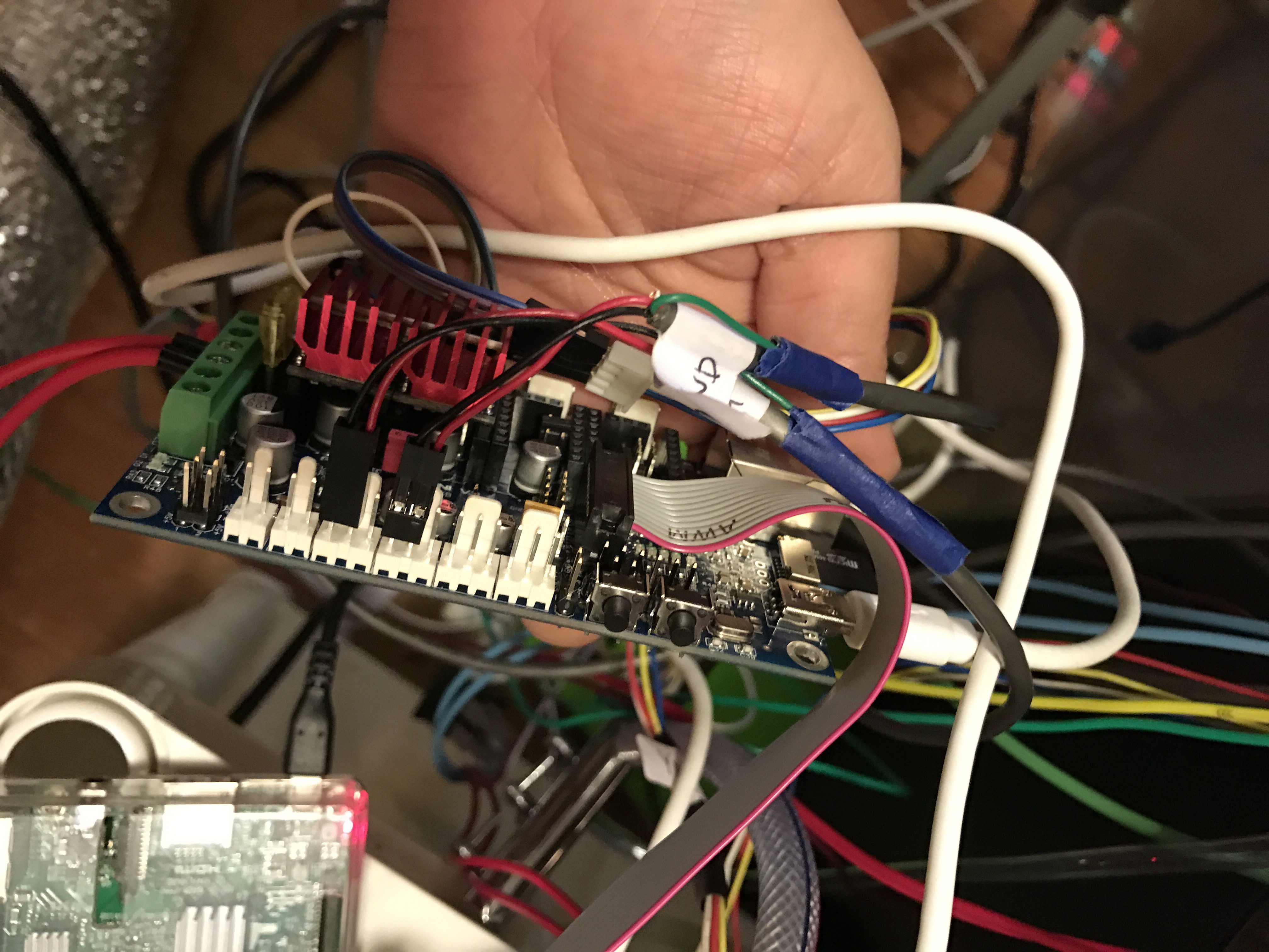

Can you take a picture of your board with the estop wiring?
