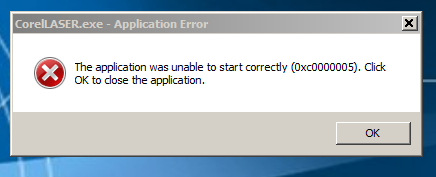

This laser machine come with CorelLaser and LaserDRW but both software give me an error message when I tried to start it. I tried on two computers first one is Win7 Ultimate version the second computer is Win 8 and both computer have same bug.

It’s not that file… The event viewer show an error with USBHook.dll

before you fix it … was it the same error message that is on the picture ?

Yes Corel Draw 12 is working fine but there is no plugin (Laser). Standalone software LaserDRW and Corel Laser from 3DCAD are not working (see error message on the picture) and if the event viewer of windows is accurate, it seem that it’s because of a file named “USBHook.dll” that is part of both 3DCAD software.
I tried to uninstall and reinstall but forget it always the same error message when I try to start the programs. Anyway software are not working on two of my computers.

Ok, I install the software on a Laptop running Win 7 64 bit and it’s working. This laptop doesn’t have a big settings because there is almost no software installed.
My bug on the other machine is probably because of another software already installed and has nothing to do with the fact that the OS is a 64 bit version.
In fact my other two machine where I have the bug with the laser software have almost the same settings and I will not crash my windows to find why it doesn’t work.
My bug is fixed for now or more “workaround” and I will begin my first Laser Test. after 3 weeks of reading, asking questions and searching, I have it and it’s time to have fun.
