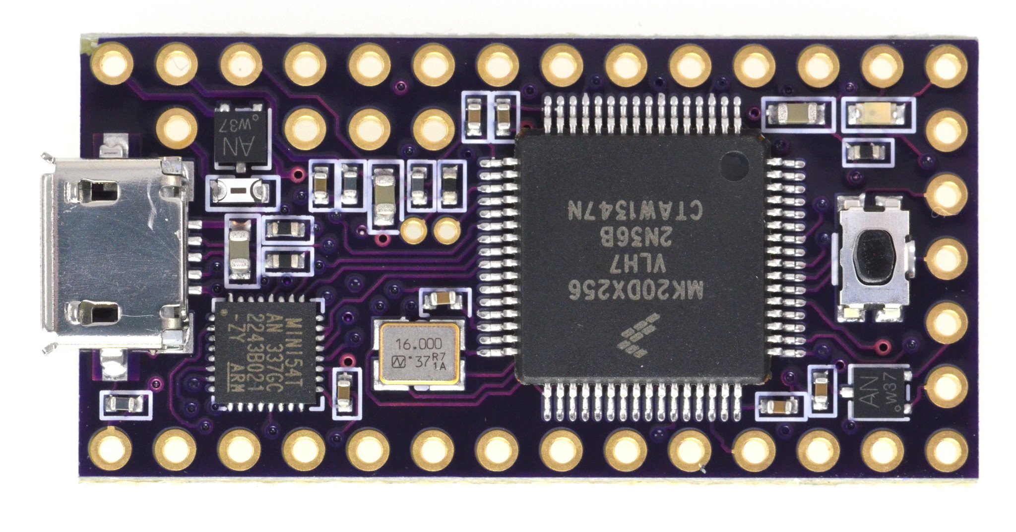

I received my Teensy 3.1 today.

Teensy 3.1 is a new arm CPU - so there’s a bunch of changes I’m going to have to make to support it. I just got mine yesterday and will start playing with it.
I believe that it will mostly just be define juggling, but have still only made one pass over the data sheet.
