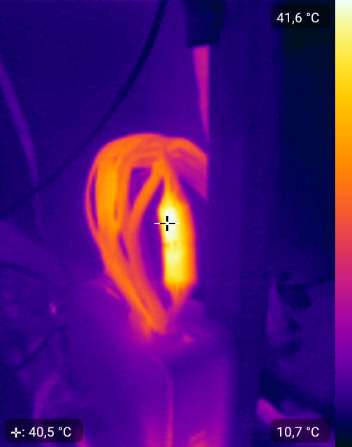

I recently bought a Flir One device and found it very useful to find
I recently bought a Flir One device and found it very useful to find bad cables and connectors on my 3D printer.
In this case the connector was so hot it started to melt!
This Dupont cable was used to power a NEMA 17 motor. I really need to buy better cables and connectors!

How it work ?
Hotend or Heated bed hooked up with DuPont connectors? Or was it to a stepper motor?

@Teo_Jerah A Flir device can show Infrared lights. With this info, an app can then measure the temperature remotely without contact and produce this image.
Dark/purple = cold ; Bright/Yellow = hot.
Check out the temperature scale on the right of the image.

@PrintinAddiction Oh no I don’t use Dupont cables/connectors for the heat bed! This would burn in a second! lol
I use these connectors/cables to power the NEMA 17 motors. While Dupont cables are cheap and easy to connect, connectors are not reliable and cables section are too small. I will switch them with bigger cables as soon I as can now that I really see how they heat up.
BTW the board (3rd picture) is a MKS Gen powered in 24V.
