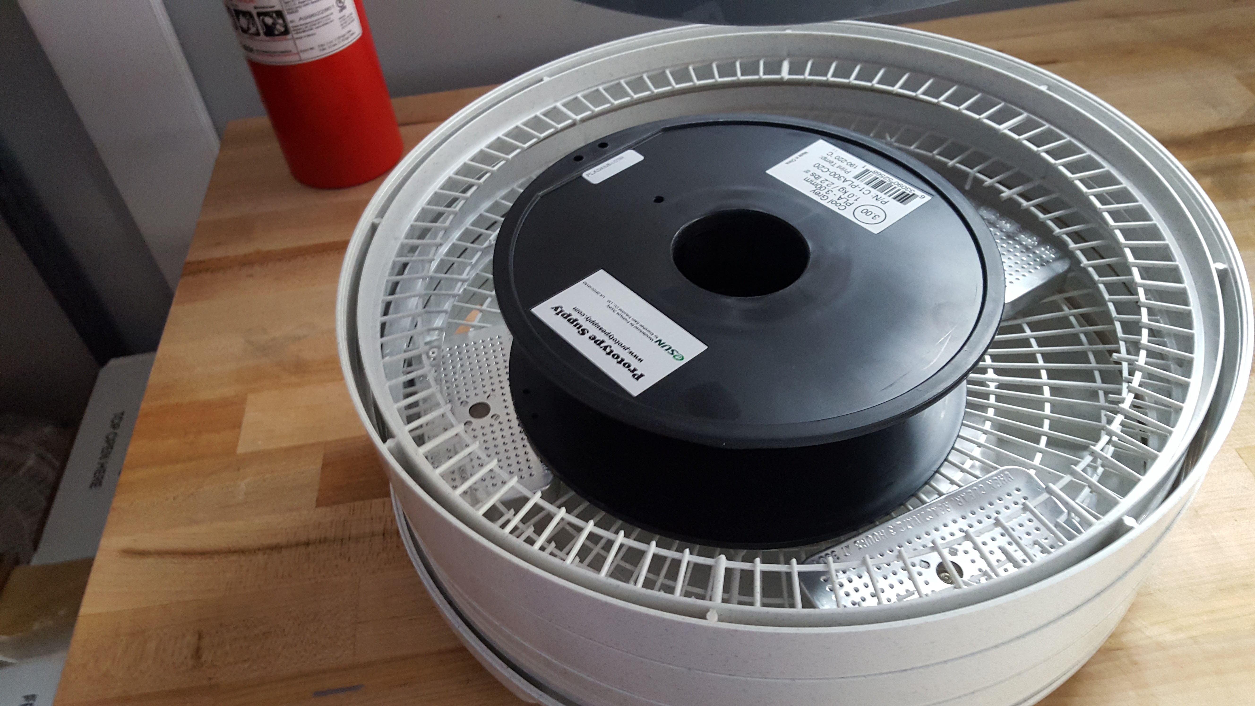

I recently bought a used food dehydrator off of Amazon so I could try to revitalize old filament. First test was with a brittle tightly coiled pla from prototype supply. A few hours in the dehydrator at 160 degree F and it came out nice and almost flexible. Going to try printing with it soon.

Heat is certainly a very fast drying method, but 160˚F exceeds the Tg of PLA, I hope the measurement was wrong. I’d be very wary of going so high. Even 130˚F might cause you trouble.

@Jeff_DeMaagd Would 100F work? I have a food dehydrator and have been wondering about this for a while.
It’s worth trying. I think 120˚F might be safe but maybe I’d try baby steps of getting there by 5-10˚
@Alexander_Pritchard A tightly wound spool might have problems sooner than a somewhat less tightly wound spool, probably because of the pressure. Someone I know had a spool where the filament started getting wavy and it was sticking to itself a tiny bit.
I suspect the high temp here has affected the crystallinity of the filament as well as the moisture. Which may not be a bad thing.
