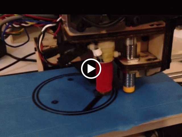

I recently run into problems with my Printrbot Simple Makers Edition.
I recently run into problems with my Printrbot Simple Makers Edition. After some successfull prints I got two problems:
  1. The extruder makes clicking noise when drawing long straight lines and it seems it is retracting or slipping (see video for sound an at 0:40 you can see the axis even “bouncing backwards”. Because of that the filament extrusion is not sufficient.
  2. On the other hand the surface quality is getting really ugly on top surfaces. It seems that layers are not sticking to the ones beneath them…
Before this happend I successfully printed with the same settings and the same filament. Then I experimented with flexible filament and installed a filament guide (I deinstalled it afterwards).
Any suggestions?

@Aaron_Kable No. I just inserted the new filament and extruded until no old one comes. How do I suppose to clean an Ubis hotend?

Do you suggest more ore less current? The motor is not very warm.

I got the skips under control, I think. I cleaned the bolt, realigned bolt and filament guidance and at the moment its ok. The extruder motor isn’t even warm. But the surface quality is still bad.
