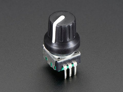

Your description of being able to push down on it sounds like a rotary encoder instead of a potentiometer. I’ve bought several from adafruit that have a good feel.
There are various libraries out there to use with rotary encoders. You might also need to add a bit of debounce circuitry (a few resistors and capacitors) if you’re missing steps when turning it, but depending on your use it may or may not really matter to you if you miss a few steps while rotating.
Ahhh good call, it may very well have been a rotary encoder instead! In fact it makes more sense since rotary encoders lend themselves more to a library than a simple pot. Thanks!

Or even: https://www.sparkfun.com/products/10982
Rotary encoder with RGB backlit knob!

That was probably me, and yes it is a rotary encoder. There is a great library for it which I think I had installed via the Teensy software.
I ended up not liking it much. I found that it would register a count before settling into a detent. I.e., you could activate it by turning it slightly, bouncing it off the contacts but not hard/far enough to get the “feel” of moving it to the next setting. This was not ideal for a wearable and I replaced it with up/down buttons and an actual pot.
