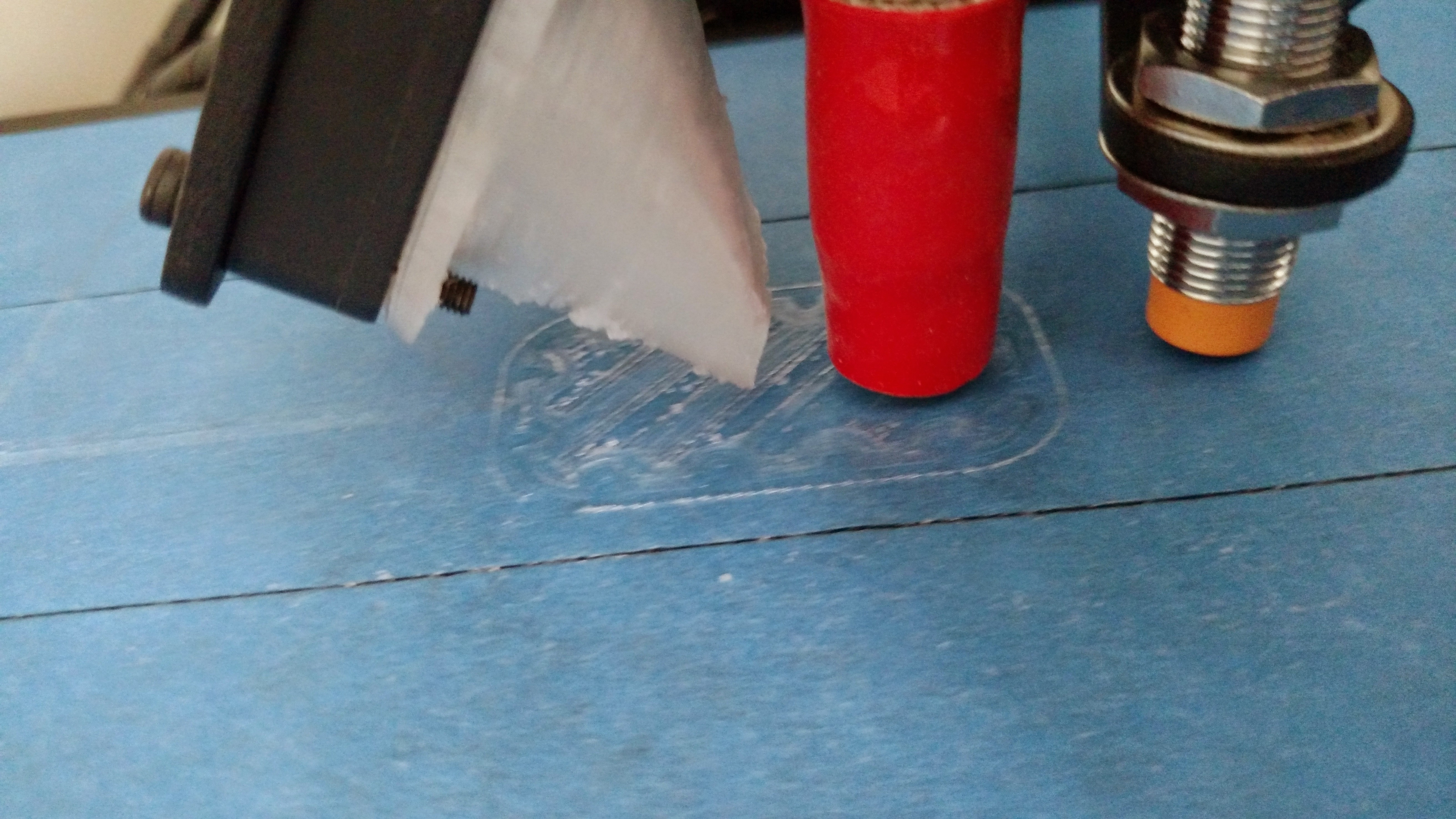

I reverted back to default Slic3r settings per the advice on the comments in a previous post I put on here. I still get a lousy first layer. I’ve noticed this happens on my top layers too. Suggestions?
I believe the extruder multiplier was 1, but I’ve tried 1.2 and the temp was 205-210 for PLA.
I wish I could help. I abandoned Slic3r due to poor bottom layers (appeared to be way over extruded, and the first 5 layers were really squished). I moved to CURA and now only the first layer is a bit squished (might be a tad too close to the print bed). I’m not sure what slic3r is doing, but it puts out a ton of material no matter what I do (I’ve changed the multiplier down to .7 ~ 1.3 and that first 5 layers are horrible). I’ve tried default settings all the way to changing one thing at a time. First 5 layers stink no matter what I’ve tried). :frowning:
I’ll try tweaking the z probe and see what happens. If no results form that I’ll try messing around with Cura. Thanks!
It’s also not clear from the picture whether your blue tape is firmly attached to the bed. But mainly what @Mike_Longnecker said: that flat perimeter with a little ridge of squeezeout around the outer edge is a dead giveaway that you’re too low.
Looks like a z probe issue as well. Did you follow Tom’s instruction in his video on youtube?

Raised my zstop a little and still get this. I’ll give matter control a shot and see what happens. Is 200C ok for PLA?
