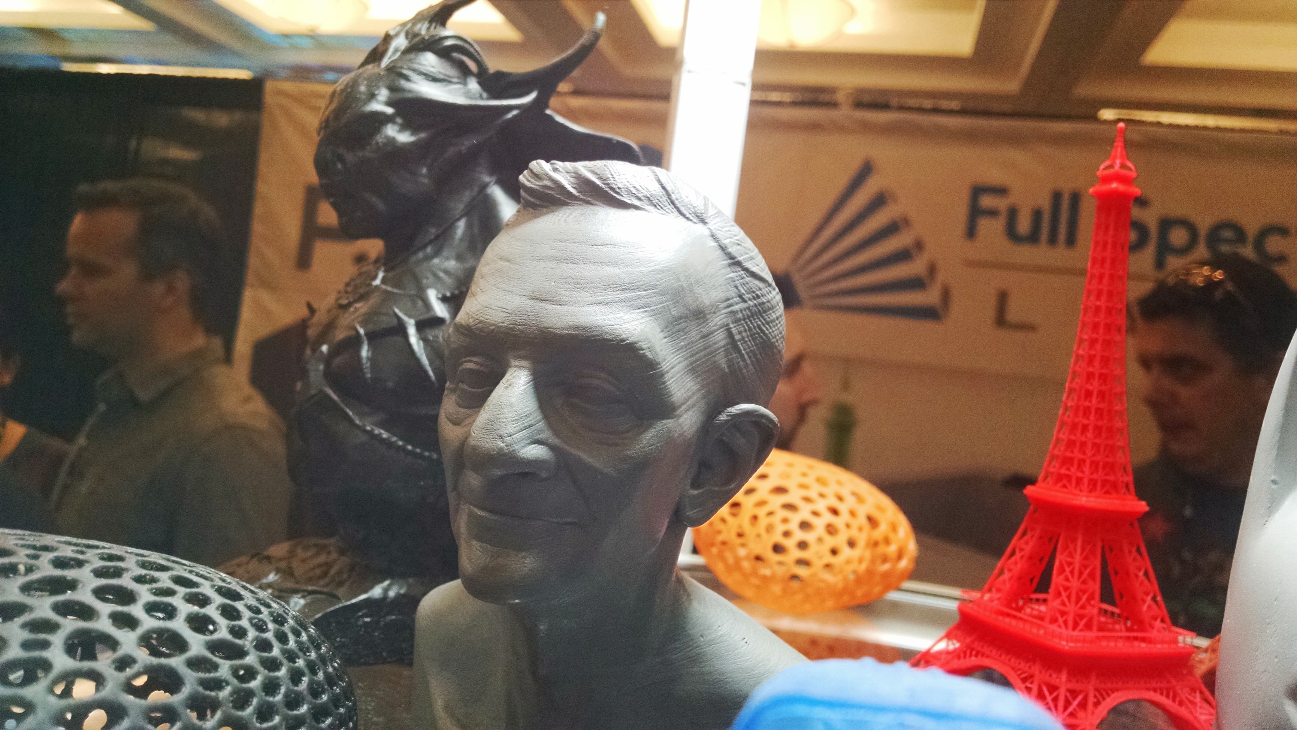

This is a resin print by Full Spectrum showing some really nasty Z artifacts. Looks like part of the mechanism (either of the build stage or the height of the vat surface) was loose when it was printed.
Not sure if this indicates a damaged machine or a flawed design, but the fact that they deemed the print good enough to put in their display case doesn’t bode well for the quality you can expect from their printers.

Is there any way that it could have happened after it was put in? That’s the only excuse I can think for such a bad issue.

@Justin_Nesselrotte That type of layer line striation can easily happen during a print, but I can’t think of any way that it could happen after the fact.
BTW, I didn’t get any other good pictures (or inspect everything that closely), but this issues was clearly visible on at least one other print in the display case.

@Whosa_whatsis ​ I know it can with fdm, but I’m not sure how it happens with resin. Care to explain?
Two causes I can think of. First is the build platform shifting while the print is being peeled from the bottom of the vat. This could be loose mounting, parts that are not stiff enough, play in the leadscrew, etc.
The second is the surface of the vat shifting. As each layer cures, you’re essentially gluing your print to this surface, then you need to pull it free to allow resin for the next layer into that space. If the peeling process pulled the bottom of the vat up strongly enough to deform it, shift it so that its thickness varied slightly, or lifted it and failed to settle it to the exact same height that it started, this would cause an inconsistency in layer height.

On mine, there is one screw holding the z-axis in place and it makes it very easy for the build plate to twist. My guess is this is what happened.

Thanks for posting this. That is my digital sculpt there. I had sent them the file during their kickstarter campaign to see how their Pegasus handled organic models. I was not impressed back then and I’m still unimpressed.
I’ve also asked them to not use my work to promote their printers at tradeshows. Or if they insisted to at least credit myself as the artist. Did you see a name next to the print?
@Joel_Mongeon I don’t recall seeing any kind of attribution on anything there. It was several months ago, so I may just not be remembering, but I usually do notice when people put out attribution cards because (A) it’s rare and (B) when they do, it’s usually the Thingitag cards that I designed.
