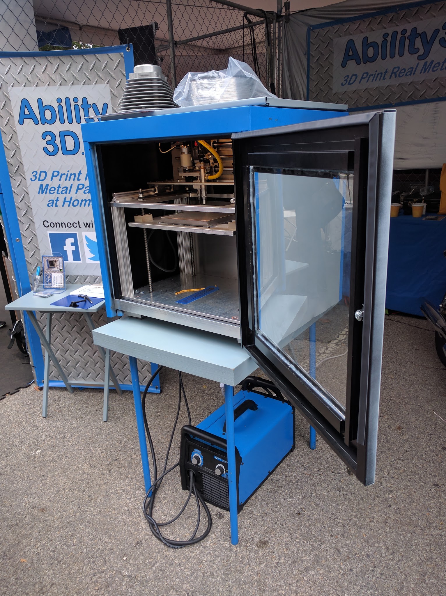

The first one I saw was a 3D metal printer made out of a MIG welding rig and a milling head on a 3-axis cartesian bot. It was enclosed in box that was supposed to get filled with an argon atmosphere, but didn’t even have weather stipping to keep it from flowing out (and air flowing in). Worse, it had big window with nothing but a clear plastic sheet. This machine had obviously never been turned on, or someone would have gone blind. When I pointed this out, the builder said that, yeah, we should probably replace it with something tinted. He then said that he wanted it clear so that you could watch the milling (which was supposed to happen each layer), then realized that if he tinted the window, he would only have to turn on the RGB LED strip, apparently not understanding the difference in brightness between indirect light from low-power LEDs and a welding arc.

That mig one is frightening, I can only imagine how many other safety measures are not taken.

Sounds like low grade scammers. You did the best you could. And milling on welded structure, oh dear. I know there’s a DMG Mori machine that does similar, but not on a MIG weld. But it’s not a fun thing to do.

Well @Whosa_whatsis ; Ability3D is down here, and a buddy of mine called me over during our makerfaire – with the Ability3D guy standing right there, he asked what I thought about it. I told him “I don’t believe it’s true, I’ve already had a trusted mentor look at their machine and call bullshit on it.” – the guy handed me an aluminum piece of metal, and said it was something that came off of the machine, but to be careful to not drop it because it was the only piece they had.
So I calmly looked at him and said “if you have a working machine…how is this the only piece you have?” It looked like a bad casting that had been milled on 5 sides. My guess is that they thought the milling swirls looked like a nozzle path?
He didn’t answer.
It’s possible, but there are other aspects that are cause for concern. Even if they managed to solve the issues of cooling, overheating and turning the part into a puddle of metal, it wouldn’t make sense not to drop it. If it’s working, then the part should be no less strong than cast aluminum. If its so weak, then there is no point in it.
@ThantiK It was aluminum? Even if the process he described to me worked, it wouldn’t be able to do aluminum.

@Stephanie_A he said don’t drop it because he didn’t want it lost…as it was apparently the only one.
@Whosa_whatsis and yes…aluminum. Even said directly to me that it was aluminum.
“printing” with a MIG welder is absolutely possible, a friend of mine made a proof of concept last winter by using zip ties to attach a MIG welder to a large CNC table, this was the result on the second try (and yes, the back wall is supposed to lean outwards):

Yeah, that much has been done before. http://www.appropedia.org/Open-source_metal_3-D_printer
It is, however, much more difficult than this guy obviously realizes, and there are a lot of other problems with the claims he’s making.
It gets worse, they’ve got $550k in funding now for a printer they claim works. Problem is, they made the mistake of buying a model from shapeways and passing it off as their own until the owner of the model saw it and busted them. a bunch of unsuspecting people who dont read the comments are about to lose their shorts this week https://www.kickstarter.com/projects/1947576577/the-nexd1-the-first-multimaterial-and-electronics/comments
