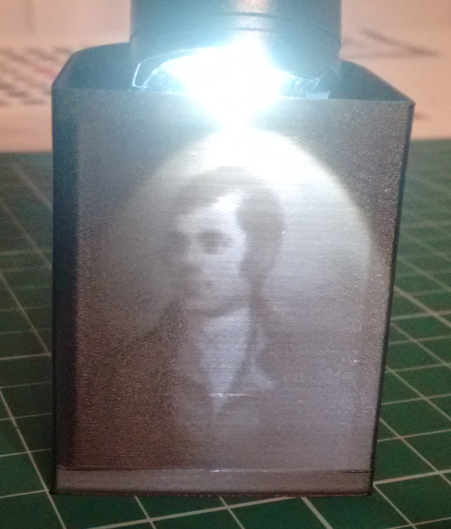

I scaled the image down to 64x82 in gimp and increased the brightness and
I scaled the image down to 64x82 in gimp and increased the brightness and contrast - much better than the previous over-ambitious attempt. (@Brook_Drumm it appears you can make lithophane by varying the speed of a spiral print).
That’s a really great job. Could you post a pic without the backlight? Can you see the face in it at all without light?
@Ian_Lee_Sr You can see it reasonably well if it catches the light just right. Transparent filament would probably help. I’ll probably dig some out tomorrow.
I’m really not sure whether to be proud that it came out so well or embarrassed as I think it means my printer under-extrudes when it goes faster.
I see. So, maybe not quite as cryptic as the traditional approach but still very impressive. Nice job. I wonder if the effect works over long lengths or does the extruder eventually catch up and the fading fades out?
Make sure you are not underextruding and then make a post? Someone was posting about varying speed for clearish PLA lately. I forget who. If they are not under-extruding then maybe you will get good results by varying speeds regardless of if you are underextruding or not.

@NathanielStenzel It was @Mark_Wheadon 's post that inspired me to try it. I believe he is under-extruding in the fast sections too. My printer doesn’t under-extrude normally but I believe the speed change causes pressure imbalance. (This effect is why slic3r’s autospeed feature is useful.)
@Mark_Hindess of course, the longer filament is in the heat zone, the more it breaks down chemically too.
That looks great – there’s a ghostly feel to it that matches the old source material really well – it doesn’t look like a hack, it looks like a finished product to me.
BTW I’m not under extruding on purpose. In fact I know I’m not under extruding because the extruder distances are absolute in the code I’m post processing, so if I’d messed up the extrusion when I chop the vectors into pieces there would be a mess when the GCODE I haven’t changed was executed by the printer. Interestingly I am seeing effects like under-extrusion, but exactly the same amount of filament is being extruded as in the un-processed GCODE. I’m getting thinner parts without under0-extruding. See https://plus.google.com/+MarkWheadon/posts/MLwbkrgMTeW
By the way – I will check, but I believe I am getting thinner parts when the printer is printing slowly, thicker when printing fast. And yes, I know that makes no sense.
@Mark_Wheadon is your printer direct drive , or Bowden?
I’m curious if you are seeing artifacts due to Bowden lag.

@Jason_McMullan It’s a bowden system – a Kossel Mini Delta. And yes, I think I may be seeing something similar to a ringing effect at the transitions.
BTW guys I was wrong – faster -> thinner, which makes more sense!
