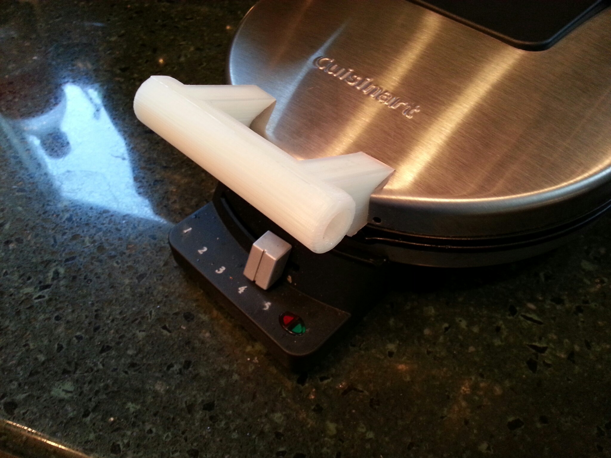

I scored some Brownie points, by printing a replacement handle for our waffle maker.
I scored some Brownie points, by printing a replacement handle for our waffle maker. The original handle broke off several years ago. The handle was designed using DesignSpark Mechanical, and printed on my Mendel90 printer with E3D hotend. The filament is 3mm Taulman Bridge Nylon. Right now I can’t say enough good things about this filament. So far I’m at 100% successful prints with it, except for one where the filament kinked going into the feed tube, and starved the printer.

Also, how well does it hold up to the heat?
I have yet to try it, But the mounting surface doesn’t get hot enough to sizzle a wet finger tip, so under 100C shouldn’t be a problem for the Nylon.
@Robert_Wozniak , be aware that Nylon’s Heat Deflection Temp is only 60C. Doesn’t take much to get it to warp.

Have you performed a burn-in to make sure that the nylon does not melt? I would attach a heat resistant material on the areas that are in contact with the waffle maker.
I turned the waffle iron up to max for 15 min. It seems to be fine.
