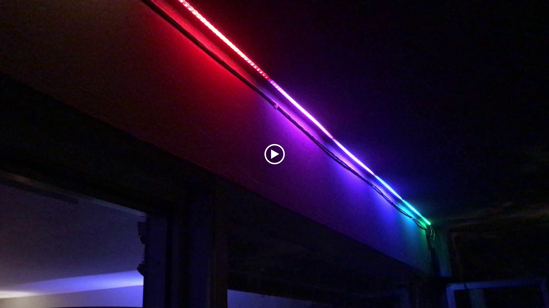

In the photo below, you can see my controller unit. In it is a little ESP8266 mini and a 10 amp DC-DC converter. The 5V side powers the LEDs and microcontroller, and the 12/24 side has a passthrough. Then, on the other side of my LED strip there will be another DC-DC step converter that knocks the voltage down to 5V. No I have both ends of my LED’s powered and I’m not using super-thick wire.
You can see the results in the rather poor quality video. You’ll see a little box on both sides of the 300 LED strip. One is just a DC-DC converter, the other is the box below, which is plugged into a 24V “laptop power supply” I picked up on amazon. And yeah, I realize this stuff isn’t outdoor rated gear… it is, however, fairly protected from rain and moisture. Someday I’ll make it more rugged…
