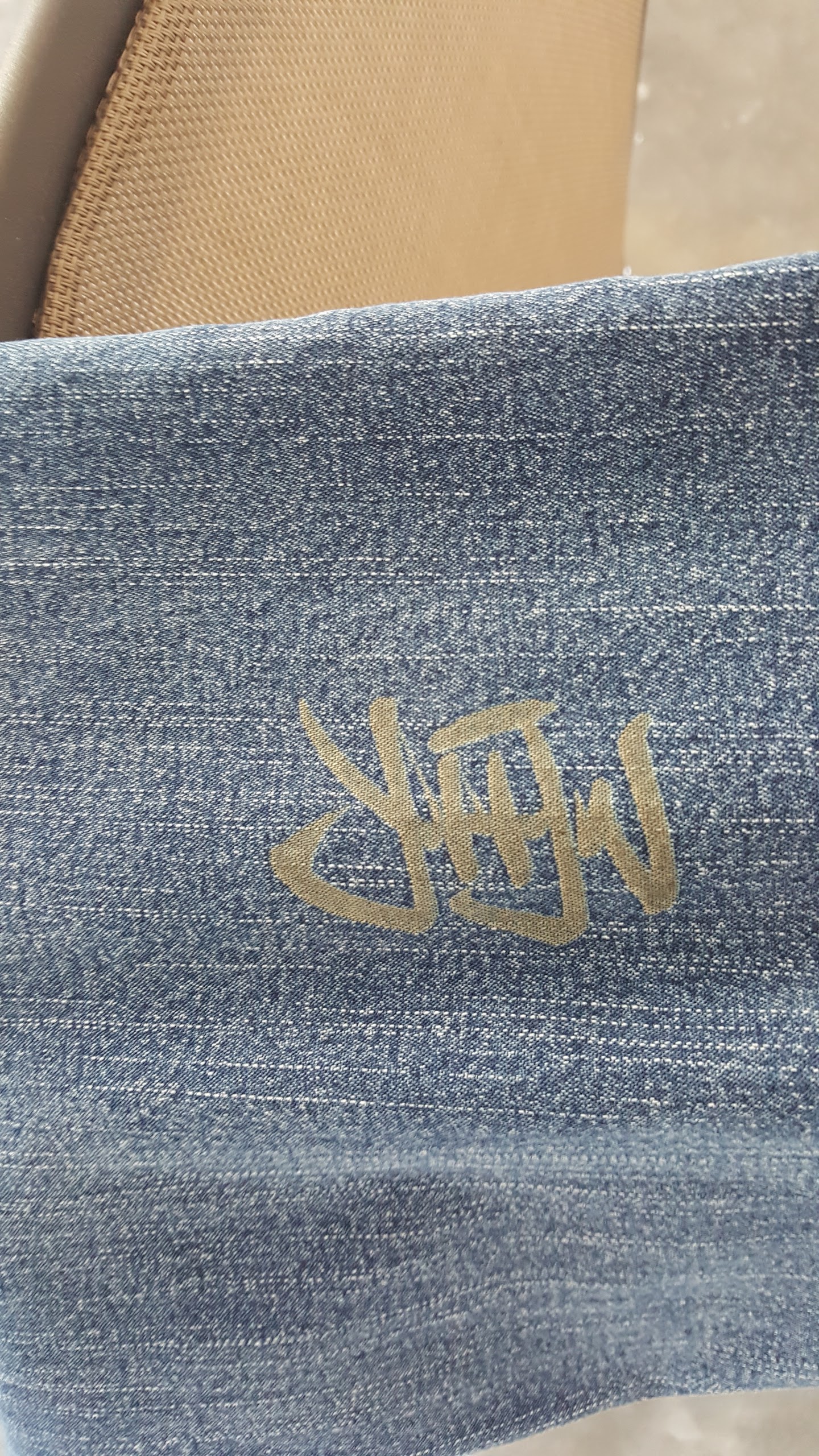

I see designer jeans in the future!
Looks good Scott. Just got to be careful to not hit it with too much laser. Gentle like this makes a nice effect.
@Yuusuf_Sallahuddin_Y …that was 10% power and 300mm/s speed…turned out great.
Have you washed them?
@Ariel_Yahni_UniKpty …just in the sink…not in the washer…but it’s still sturdy right there where the raster is.
I did mine with several different setting and that better one faded once out of the washer
Throw on some fabric paint and let it dry before you laser… I had to do something similar on some black leather I engraved to make it “Pop”
