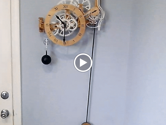

I should have asked this a long time ago. Is there any way to do a reverse brim on a 3d print? I spent a long time cleaning each tooth of each gear with an exacto knife because I wanted good bed adhesion and the first layer squished out a little bit. Most of the time that is never an issue, but for this project, it was a huge issue. If there is a way to slice it with one less perimeter on the first layer only, that could certainly help the cleanup. The alternative is to make the model have smoother edges. If anyone has any suggestions on how to do that with sketchup, I am interested in that solution too!
Originally shared by Daniel Jones
It ticks! This project has taken me a long time, but I am happy with the results. It is nice to hear it clicking away as I work.
The plans are very reasonable and can be purchased at http://www.woodenclocks.co.uk/index.htm

BTW - Love the clock. How long do you get from a single wind?
I get about 15 hours. The instructions say it should get at least 12 hours. The drum that unwinds could be made to have a smaller diameter and potentially get close to 24 hours. At 6 lbs of weight, it has plenty of torque since the plastic has less friction than wood.

Now that’s a great looking clock.
