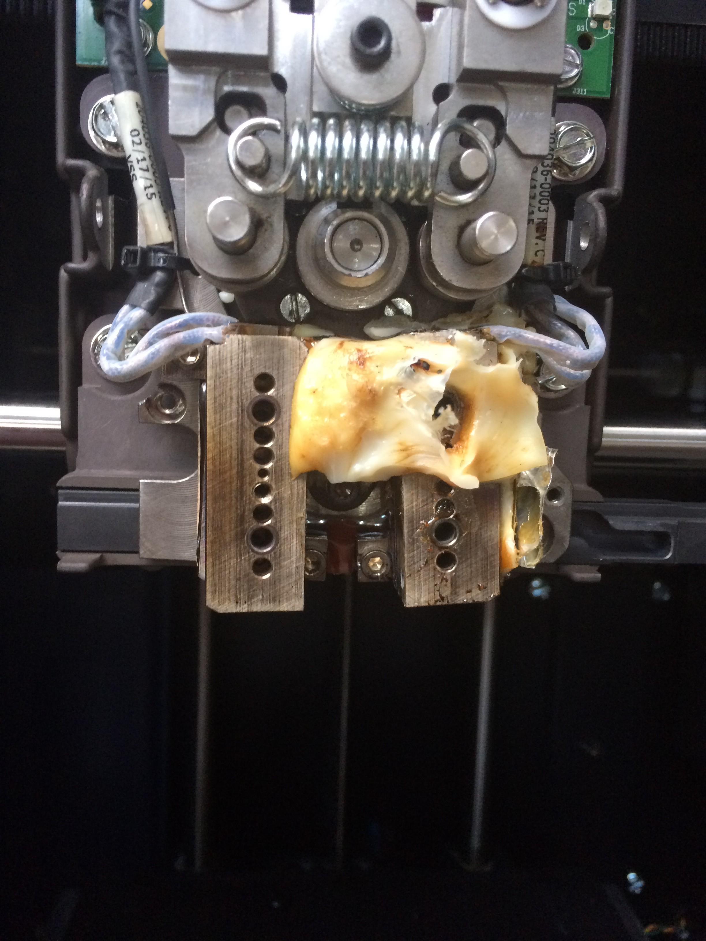

I spend 3hrs one day and another 2 fixing a @Stratasys UPrint se. it had a bad head jam and we had to heat the cover until we could get most of the plastic out and remove it. Luckily it now works.
Looks like a switch mechanism for two filaments with one feeder wheel. It seems Two side-blocks have filament paths.Are they act as two heat-blocks? And there should be two nozzles underneath?
Brutal
@Xiaojun_Liu correct. The se uses a bar in the back to switch which filament is actively being driven.
