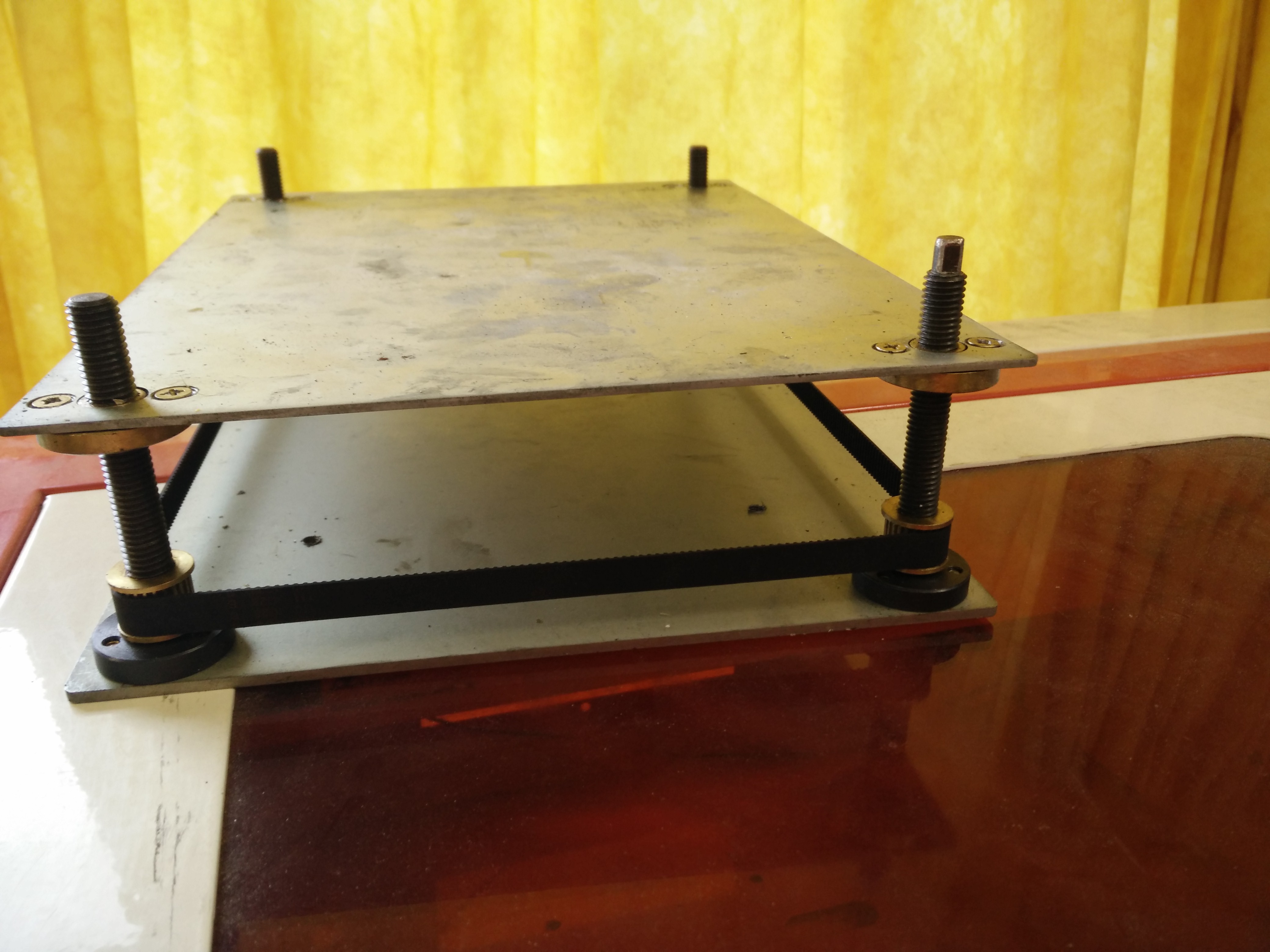

Inside it I found this platform (and a honeycomb layer on top) - which was quite pleasing .The downside is that I found the X stepper uses a flat flex cable coupled with the end stop (at least I think it is, I can’t really make it out), the Y doesn’t appear to have an end stop. I’ve decided to get some end stops I can more easily put in the places I think they should go.
