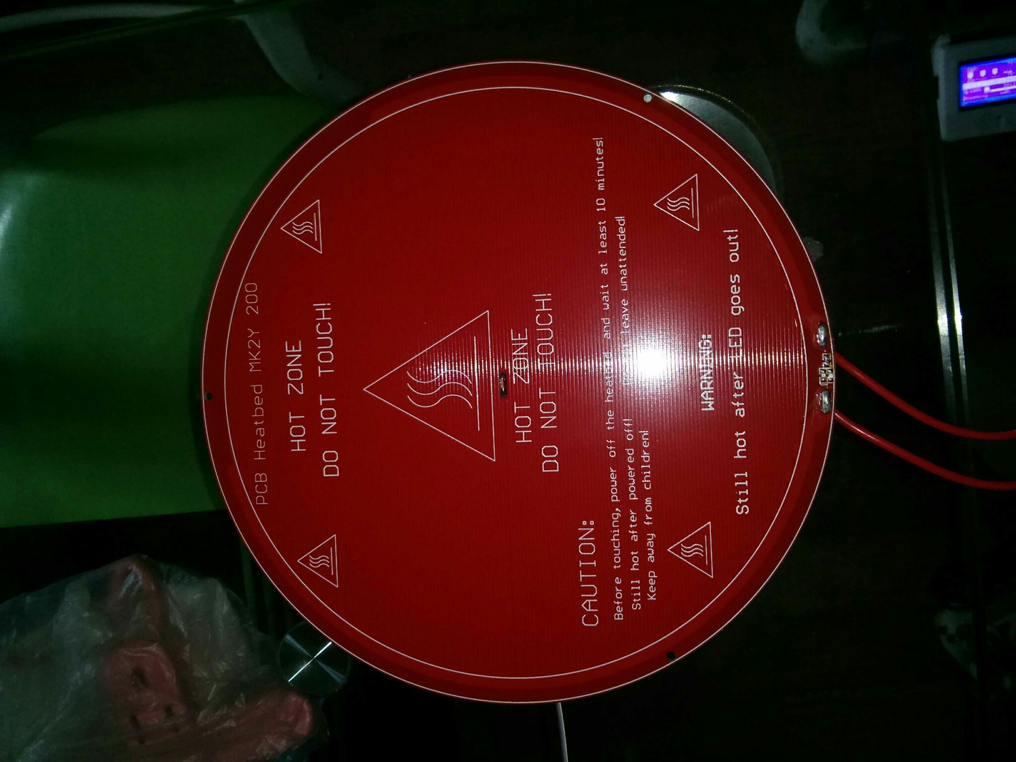

I suggest add some "cloth" to heatbed ! to reduce backside heat( that probably
I suggest add some “cloth” to heatbed !
to reduce backside heat( that probably affects other components behind heatbed )
