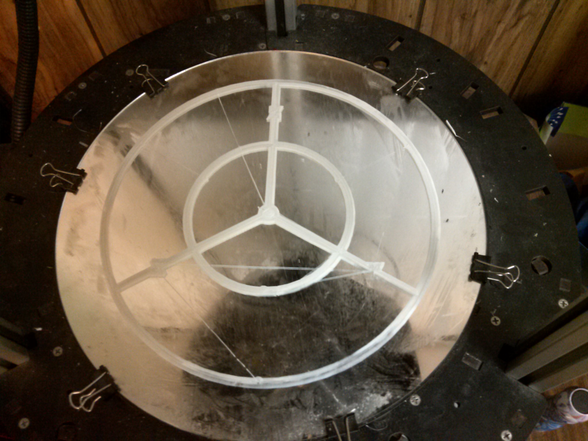

I suppose this will do.
It is actually a little thick on the back right. I am letting the stepper motor cluck (the noise it makes when it looses grip) some because I am tired of replacing quick fit connectors.
Are you printing a mercedes stearing wheel? Hahaha
That is a calibration print to see if the towers are aligned. Funny though.

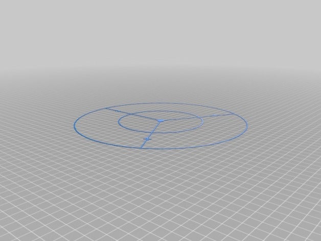

I am now working on gap calibration via https://www.thingiverse.com/thing:5971
My donut shapes are actually turning out pretty crappy, so I think the heated bed is too hot or I need a minimum timer per layer which I have turned off on this particular slicing profile.
Retraction?
You mean retraction before moving? I forget if I had that on or not. I guess I really should check retraction and perhaps Z-hop.
