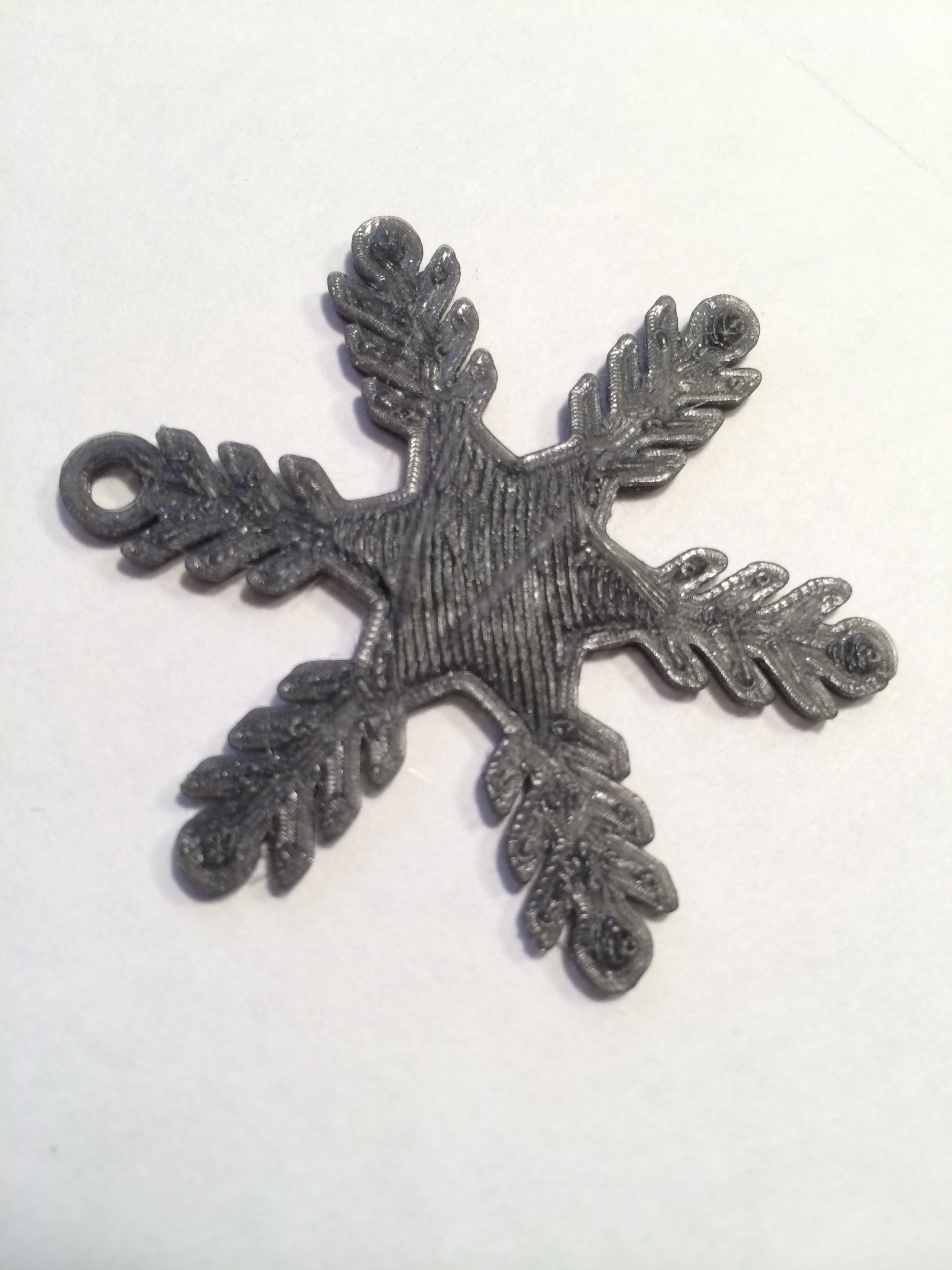

I think I finally nailed the settings on my Simple. The best print yet.
I think I finally nailed the settings on my Simple. The best print yet. Both sides of the snowflake.

Well done! What filament and settings did you use?
Looks to me like you’re probably overextruding a hair. But your first layer looks like it should. Means you’re likely a smidge away from the bed as well. The defined nozzle moves that you see along the perimeter also means something is up with your microstepping, likely a driver that needs to be adjusted (also I notice that you get it a lot in a single direction, less so in the other axis, so probably only 1 driver that needs the adjustment. Which orientation was it printed in?). Though the scale is a little hard to determine, so it might just be simply that the item is small.

Yes. The item is small. About 5cm. But there’s definitely more tweaking to do.

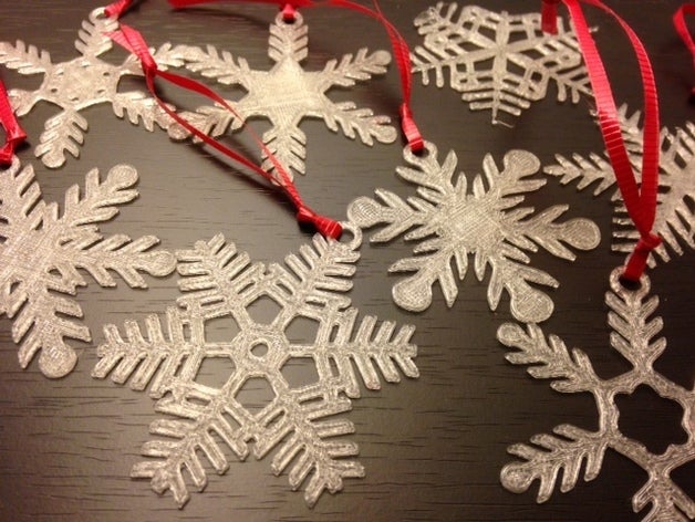

Which thingiverse item is that?
Looks like a good snowflake but thingiverse has so many…
One of the featured ones. I think it was these:
