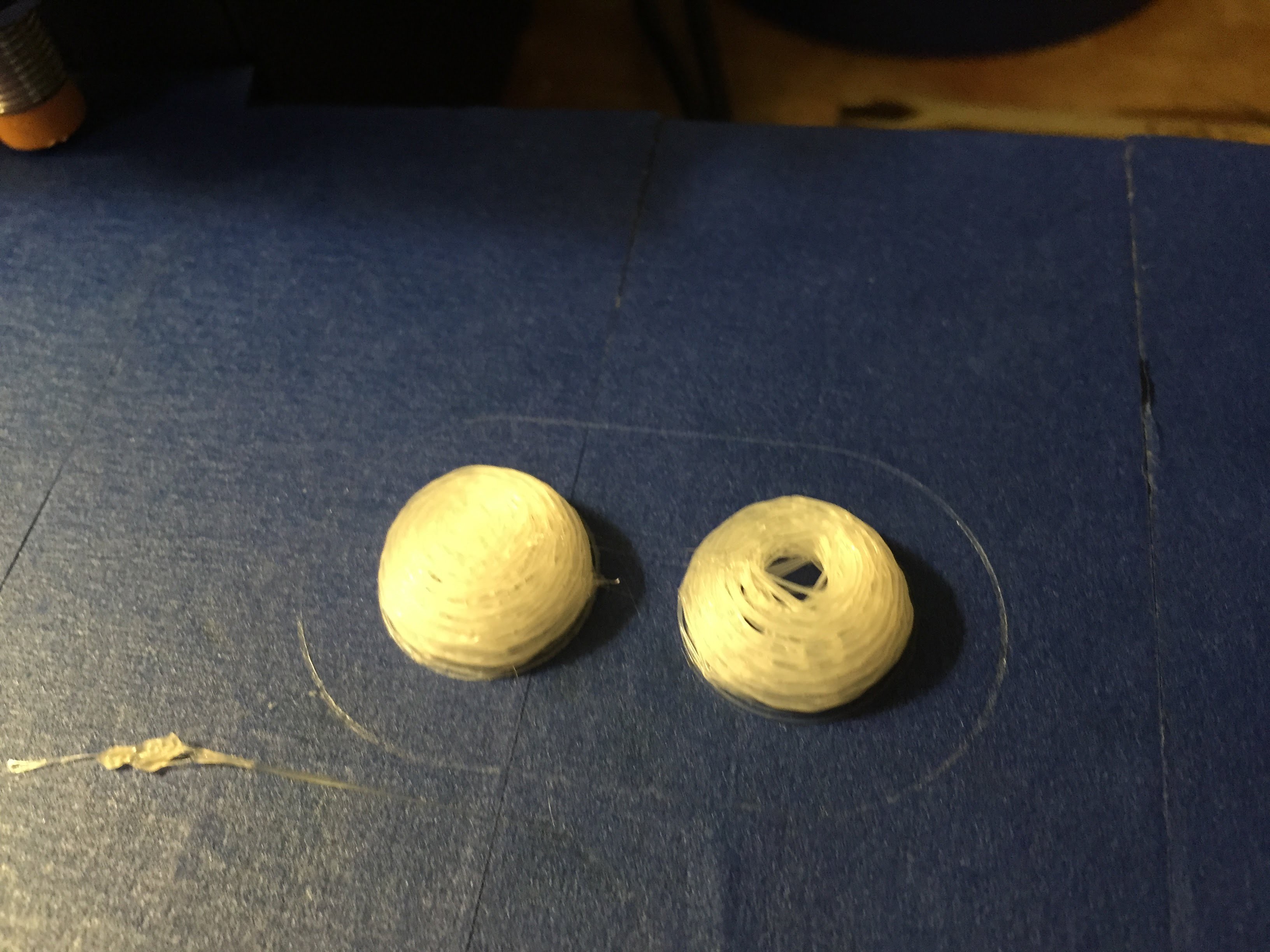

I think I have gotten past my printer calibration challenges,
I think I have gotten past my printer calibration challenges, and I am quite happy with my fan shroud. My next print was the first one I sliced from stl rather than downloaded gcode, and it is very weak and stringy. I would appreciate suggestions. Should I be playing with the extrusion multiplier, or is it likely something else?

Sorry, I should add that I am using Repetier/Slic3r, loaded with Printrbot’s recommended config, and printing on a new Printrbot Metal Simple.
I would check temperatures. Pla seems to do good at about 105c. The extrusion multiplier is for parts that are consistently slightly over or undersized.
Thanks, although wouldn’t the temp be affecting the parts I am printing from gcode files too?

205C

play with the temp a little bit, but also consider your support settings. Domes are inherently not easy near the top, because without support and/or multiple shells there isn’t a lot of overlap between layers, and thus not a whole lot to hold the filament in place as it cools and wants to shrink away from the previous layer. I spent weeks last year trying to get single-layer eggs to print on a JrV2, and the tops were always a problem.
On this little part, speed is also a factor. Try printing 4 or two. Slow it down too. With more infill (40%?), you should be good to go. I do 2 or 3 perimeter walls and on domes, 5 top layers… Usually 2 bottom layers.
This part could have been designed to be easier to print now that I think of it!

Slic3r. Don’t be on the easy mode.
Slow your top infill:

Bump your retraction up, if your an through the cal blocks and passed your golden. Ignore.
In fact, in less your in a hurry slow all of down.
I can print at 110mm/s but will run in the 30-60 range… Because… Well I like watching my printer…:-).

Just a follow up. Playing with some of the settings, but primarily the infill, and the latest came out great. Still using Slic3r, and getting the hang of it. I think I am up and running!
