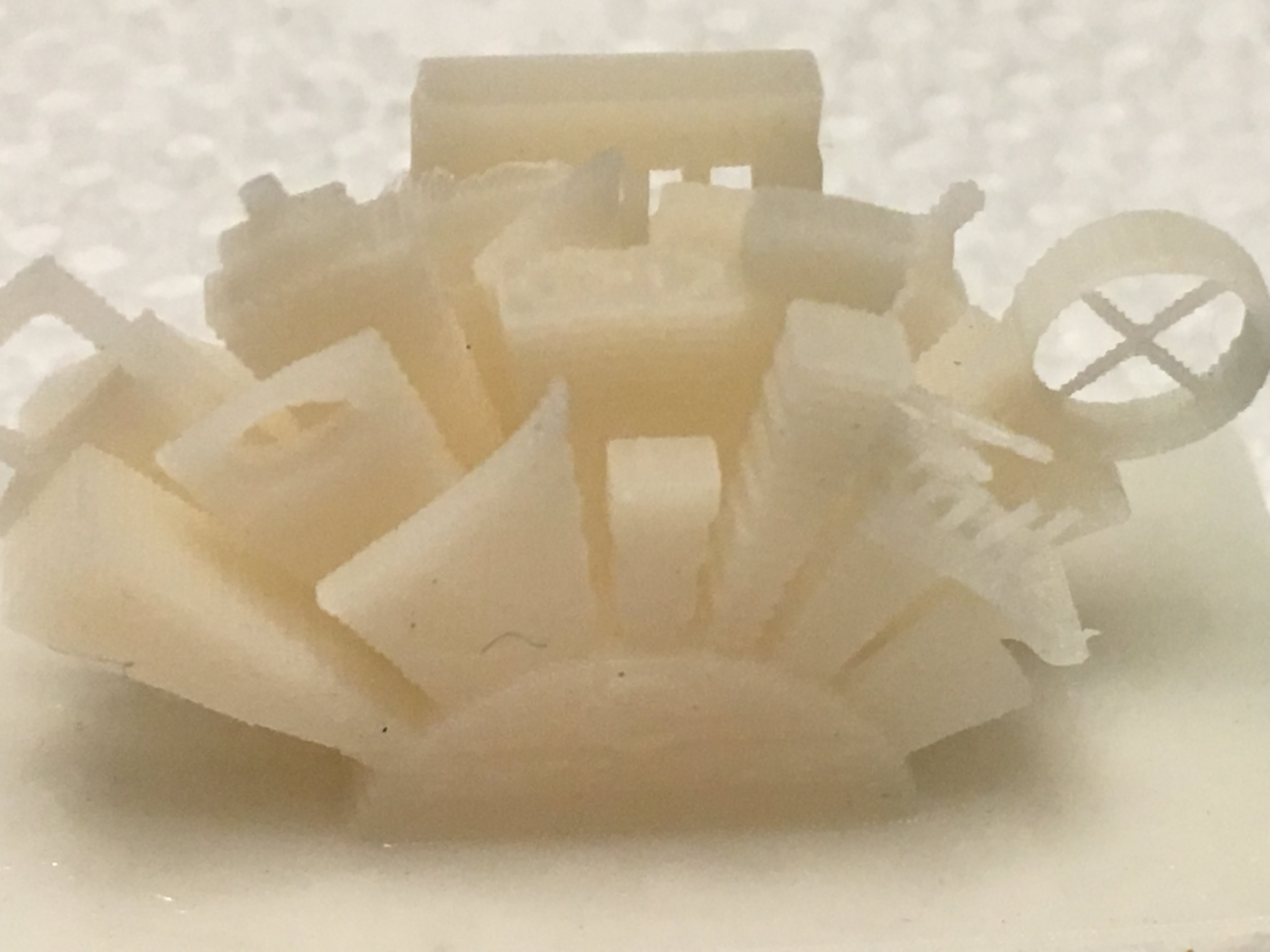

I think I might be getting close to usable settings for using Monocure FastCure
I think I might be getting close to usable settings for using Monocure FastCure 3D resin on the Morpheus Delta by Team Owl.
The following images were the result the following settings: 3 x 50 second burn-in layers and 20sec/layer after that. I think it looks promising, still needs to be tweaked…
