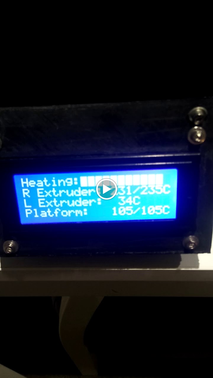

I think I’m ready to throw this god damn Makerbot clone out the god damn window. I can only ever print properly if I use the sh-tty ReplicatorG software. Using Octoprint or anything else and it just does this sh-t.
It must have something to do with the G-code to GPX conversion because this happens regardless of Slicer.
Has anyone seen this kind of behaviour? Anyone have any tips? I’ve been trying to fix this for days and have made ZERO progress.
Ok ive finally fixed this problem. It seems to have been caused by the setting ‘Recalculate extrusion’ in the GPX plugin. It was set to YES, I’ve changed it to no and its printing somewhat better.
Next problem is that the printer is printing way off the platen, rather than in the middle.
You need to set the dimensions of your print bed dimensions in your slicing software.
It definitely seems like a limit switch is broken or you have the wrong dimensions in you slicer.
Agreed with Chris Macier, and Panayiotis. Check your settings.

@Panayiotis_Savva @Chris_Macier @Noel_Kuck Thanks guys. I don’t think it’s a problem with endstops.
If I connect my laptop to the printer and use the ReplicatorG software for Makerbots it prints absolutely fine.
Using anything else just gives me no end of trouble.
I’ve fixed the problem in the video, it was a setting in the GPX plugin in Octoprint. Problem I have now is the prints aren’t centered. It’s gotta be a Slic3r setting, just can’t seem to find which one.
@Chris_Barnes what slicer are you using?
@Chris_Macier using Slic3r
