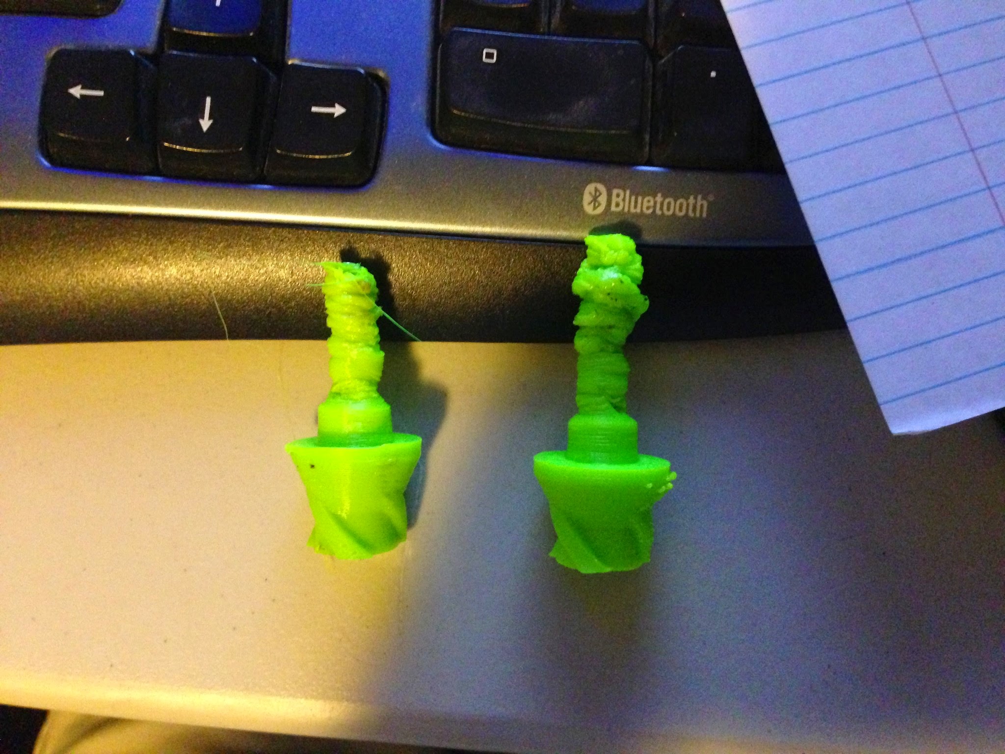

I think this is happening because my speeds are to fast do you think the same
this kind of issue with “tower” type prints is usually because the layers don’t have time too cool so yeah, either slowing down or adding a fan helps
Alright Ill add a fan and see what happeneds was going to add one anyways so I could print PLA
Thanks
Also does a fan help with small amounts of curling. Sometimes my edges seem to curl a little
no problem:)
For curling, it really depends : is the curling on the first layers only or do edges curl up as if a bit still molten ?
The first layer is nomally fine its once it starts building layers if you look at them they seem to still be molten a little and curl only on the edge of the part
Very likely due to not enough “fan” as well
If that does not help with the cooling , also make sure you are not extruding too much on the perimeters, I had that causing upwards curling too.
looks like the fan did the trick thanks
need fan and cooling logic, that is all
Make sure you have calibrated your extruder
