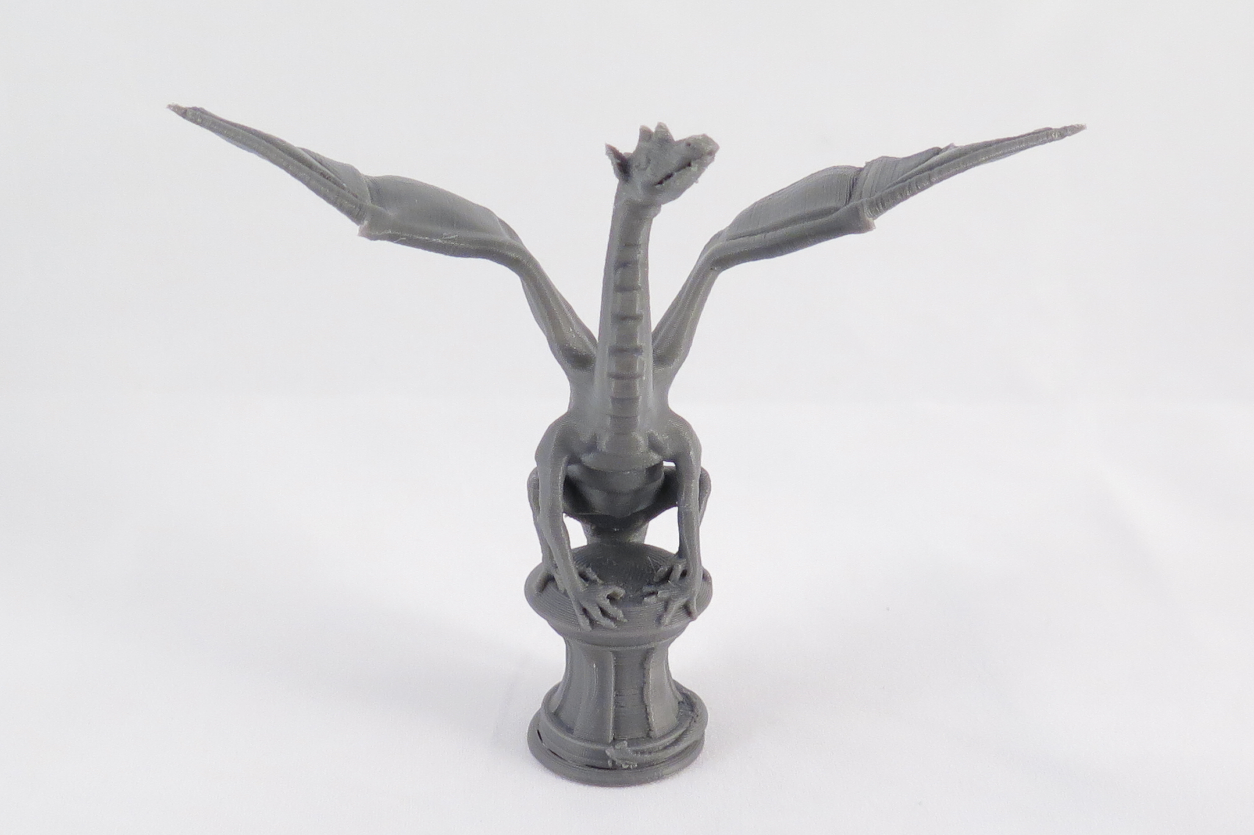

I took Aria dragon,
I took Aria dragon, heated up with hot air until soft and then rearticulated

Lovely print and the pose does give her more life. I made her as she was because I was worried about people having problems printing her. I’m writing a blog article about her - may I use some of these photo’s to illustrate a point? You will be credited of course.
Sure you can, thanks

Searching for the Hot-Air-Gun tonight :slight_smile:
I used hot air gun from my soldering station, set temp to 220C and air flow to max, blasted each side of the wing for 4 seconds
@Richard_Horne I don’t know if they have Harbor Freights in the UK, but a Plastic Welding kit is a nice tool for doing something like this. You can adjust the temperatures a little more finely and the smaller nozzle allows for more precise control: http://www.harborfreight.com/plastic-welding-kit-with-air-motor-and-temperature-adjustment-96712.html or http://www.harborfreight.com/plastic-welding-kit-with-adjustable-temperature-96464.html

+Richard Horne We had a hot air gun in the UK - I think we got it from B&Q
@Mike_Kelly_Mike_Make @Louise_Driggers Oh, I have them, just need to find one :slight_smile: I use tiny blow torches and various heating things for 3D printing. Even just a lighter for joining filament sections when I’m feeling lazy. The wings are printed almost totally solid, so it should be easy to re-form her.
