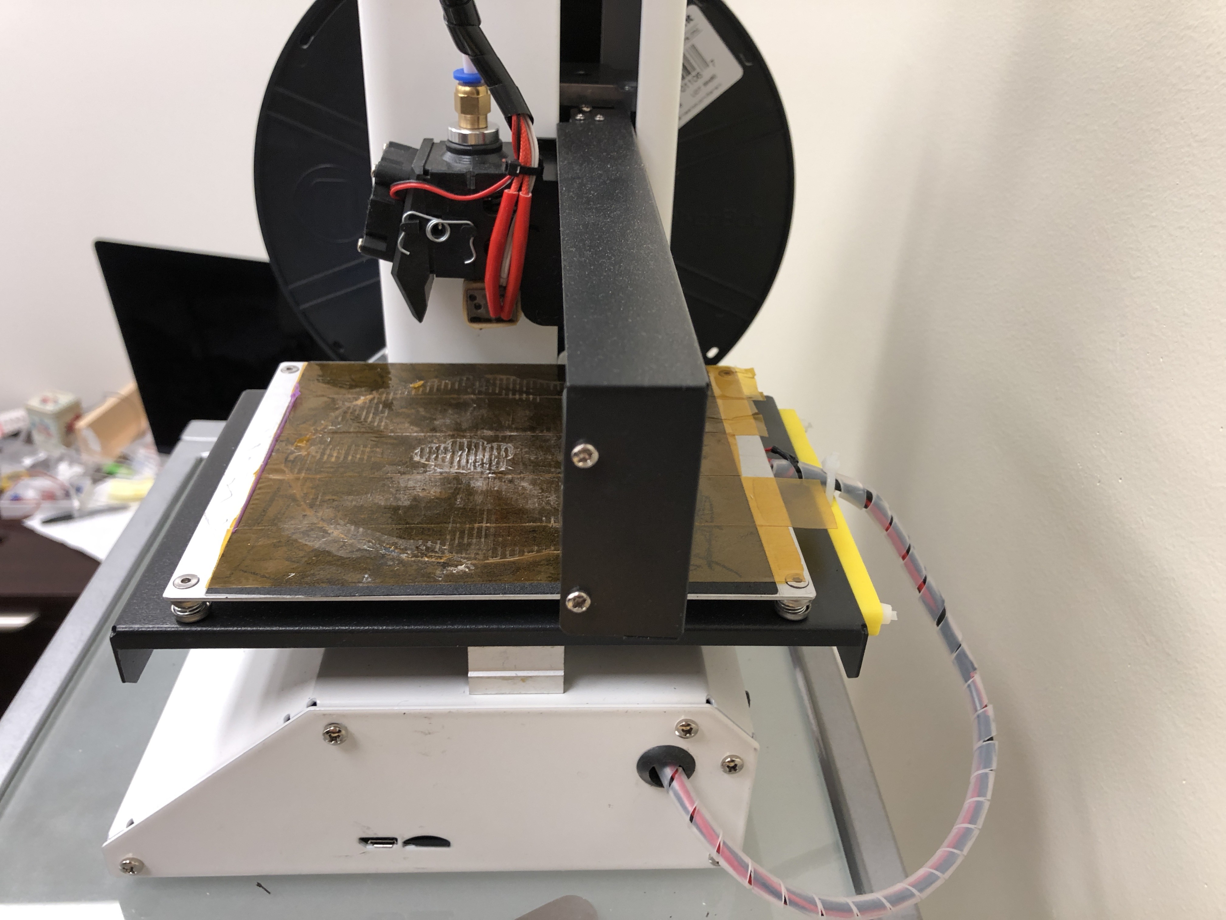

I took one of your guy's advice/tip and took aa heatgunt to it,
I took one of your guy’s advice/tip and took aa heatgunt to it, then found some googone and it worked great. Now, is just to relevel the bed and print somthing!!
Thanks to MidnightVisions
Googone is my goto adhesive solvent. If it doesn’t work then I bring out the acetone.
I love this printer. Inhave two suggestions:
  1. print a support for the back of the bed that you can strain releif a wire to. Then drill a hole in the side and route the heater/thermister wire bundle through the hole and back to the bed. Strain releived on the part you made. Soldering required. But this wire fails.
  2. use kapton and a glue stick. Works great and parts are easier to remove
Mine is exactly like that
