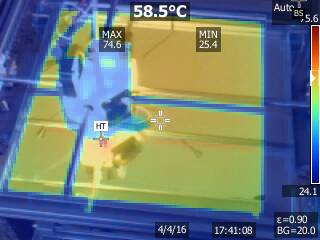

I took some pics with the thermal imager we have at work.
Bed temp is good, sp was 60°C 58-59 in the center, 2°C less on the edges.

I tend to turn off the visible light camera correlation because it’s distracting with little benefit.
