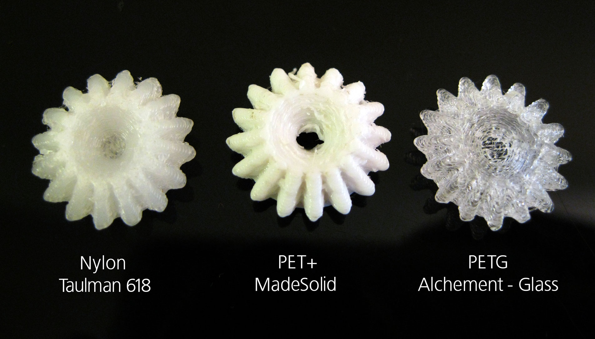

I tried a few different materials for the gears.  Here is Nylon, PET+,
I tried a few different materials for the gears. Here is Nylon, PET+, and PETG. I think the PETG came out the best. I have used PETG in the past and it is super strong. It is harder than the Nylon but not as brittle as PLA. I don’t plan on printing any of the Truggy parts out of PLA. These parts have not been cleaned up. They are pretty much right off the printer.
