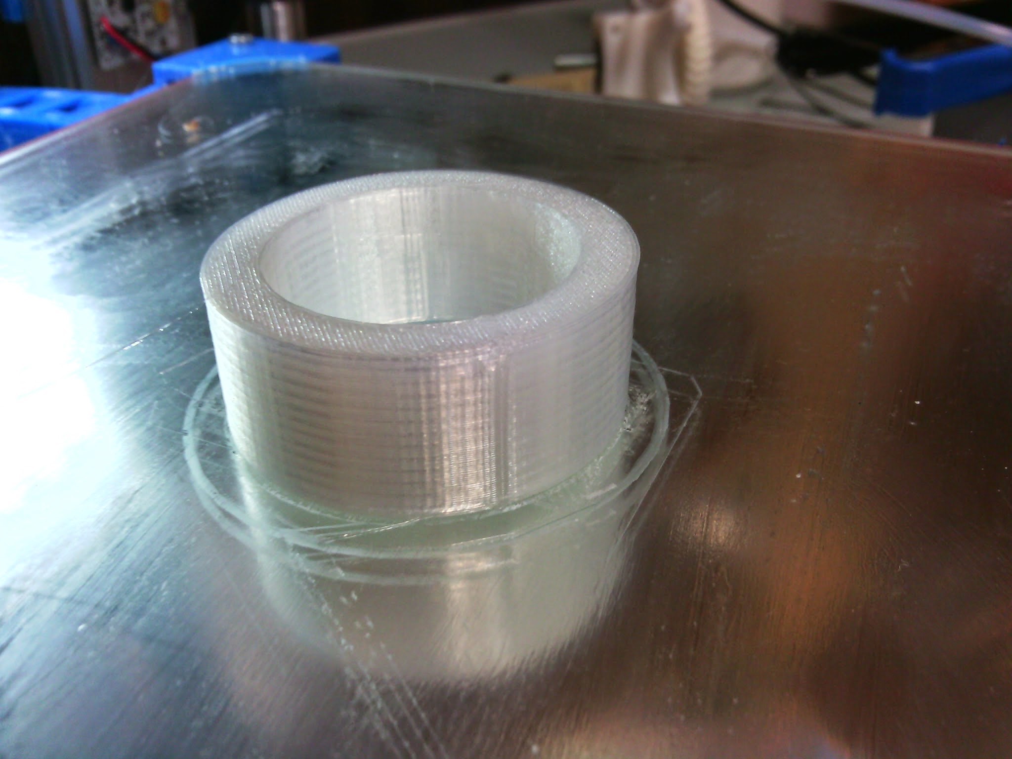

I tried the new Taulman Bridge Nylon with my Merlin Nozzle.
I tried the new Taulman Bridge Nylon with my Merlin Nozzle. I just love the material. The results with 618 were very mixed, but Bridge is a totally different game. Delamination is simply unknown to this stuff and it is rugged as hell. I will love abusing the hell out of it :slight_smile:
