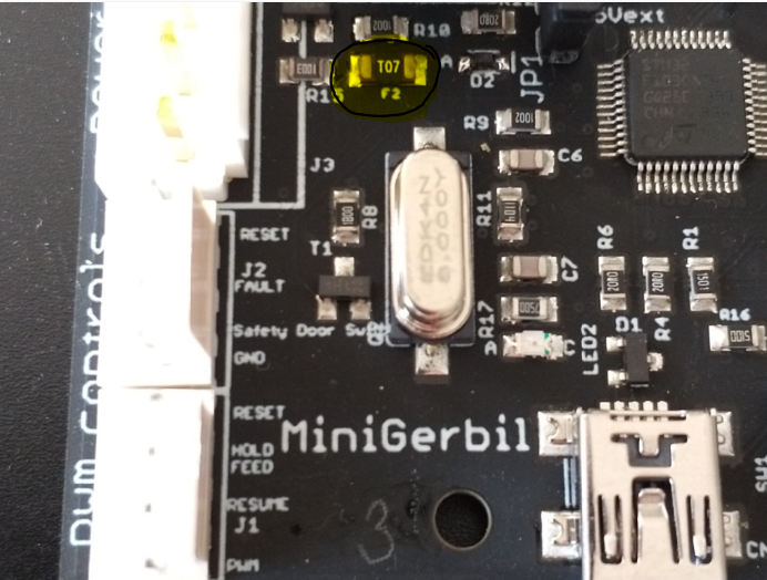

Hi, best is to measure before and after the PTC fuse F2. I suspect that it has blown since there is no power at the VMOT pin on the stepper driver boards (2 x A4988). If it’s blown you can replace the fuse and try to find out what the root cause is. Maybe one of the stepper driver boards has short? Measure without stepper drivers and see if there is 20V DC at the socket (Pin VMOT).

well f2 is blown it work then nont … in short it stop to work …i get yesterday readings from 0 to 19v in intervals every 4-5 sec and nothing any more
so where to find that f2 fuse
and what are specs for that PTC fuse ?

The reset-able fuse is rated 0.75 hold/1.5 trip Amp example SMD1206B035TF/16, I do have a few spares laying around so email me your address and I will drop it into an envelop. Are you sure it is the fuse? What caused it to blow? Normally they do reset themselves after the shortage is removed (defect stepper driver?).
sorry for late update i change drivers and steppers now work … fuse is ok i guess and have power
just bad drivers yeey
