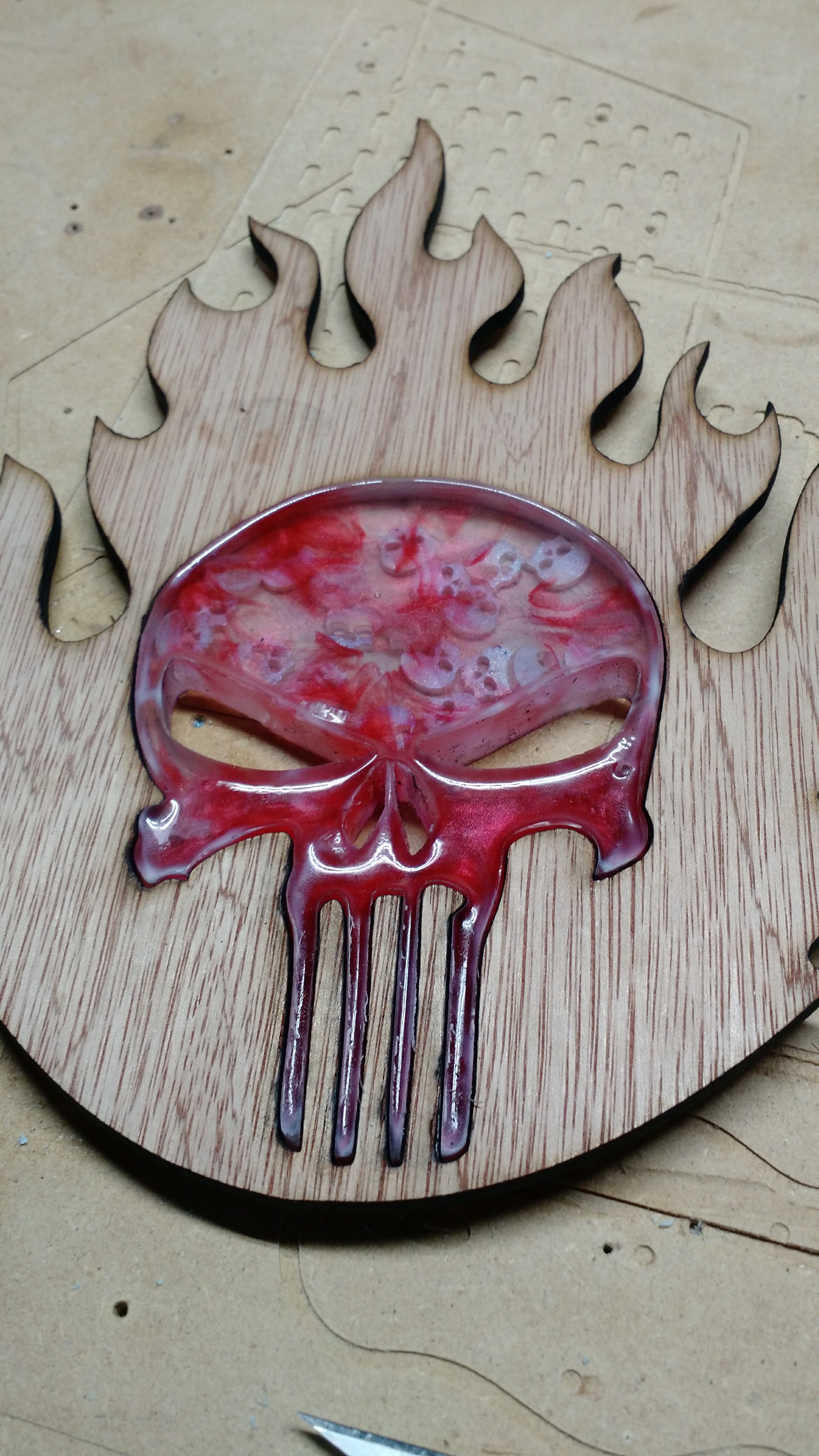

I used laserweb quite a bit for this project

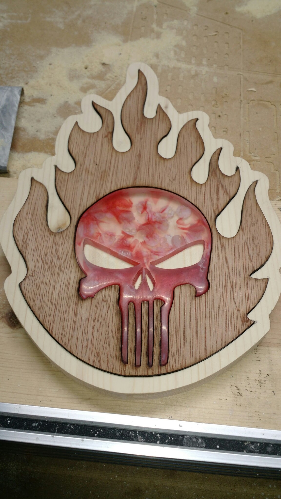

almost done just have to do some router work in some woodfor this inlay
Did you pour the resin and then machine out the eyes/nose after it cured?
@Jim_Fong ​ I 3d printed a mold and poured it then laser cut the the wood using the same vector I made the mold from. It’s about 15 mm thick. I will be machining a piece of wood to inset this in. And finally I will edge light the skull to really make it POP.
@Alex_Krause . Oh that’s how it was done!!! This is one of the nicest cnc art pieces I’ve seen and it isn’t even finished yet.

@Jorge_Robles ​ I was originally going to inset it into a piece of wood and edge light it… But I felt the design was missing something, so I went went flames to make the project catch your eye more
Looks amazing! Love the red swirled in with the clear! Nicely done!
