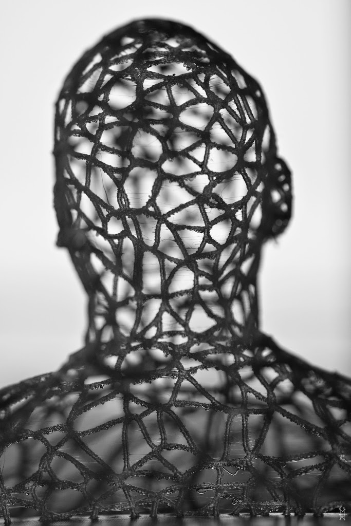

I used the Kinect scanner from my Xbox with a usb converter to my
I used the Kinect scanner from my Xbox with a usb converter to my pc, installed the Microsoft development kit to recognize the Kinect so that the scanner software (Skanect) could recognize the scanner, exported the scanner into 3D studio Max and did some editing to make the scanned model into a printable wire frame for Cura so that my Ultimaker 2 could print it.
Originally shared by Michael Williams
3d printed 3d scan
@Mahran_Meissner I used the Kinect scanner from my Xbox with a usb converter to my pc, installed the Microsoft developer kit to recognize the Kinect so that the scanner software (Skanect) could recognize the scanner, exported the scanner into 3D studio Max and did some editing to make the scanned model into a printable wire frame for Cura so that my Ultimaker 2 could print it.
