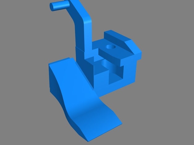

Now on to part cooling. :slight_smile: Could the part cooling duct below be adapted to fit your machine?

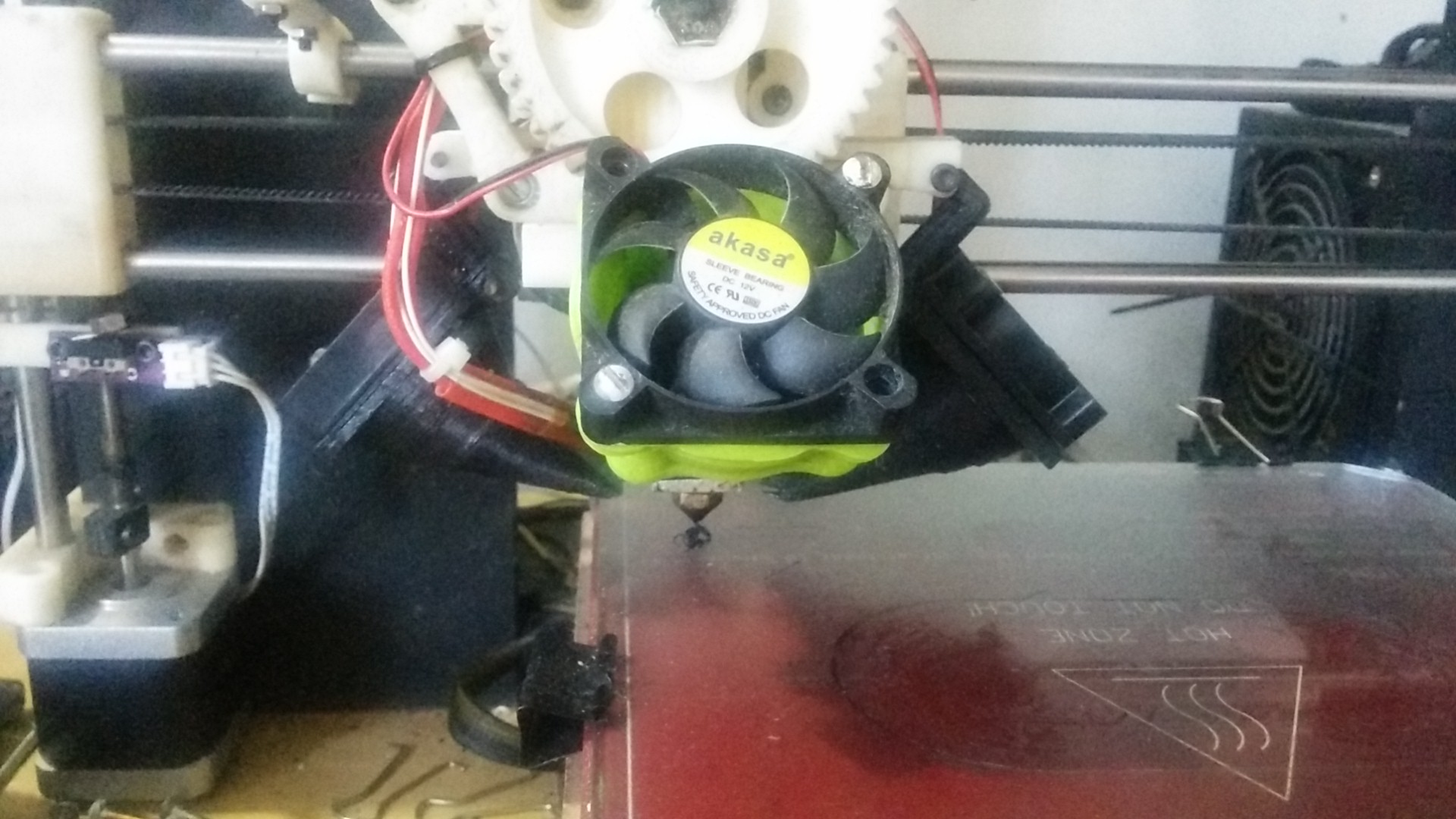

@Jeff_Parish Cooling is a problem I was not able to solve completely and/or elegantly hahaha
In Brasil, we use what we can, not what we want :stuck_out_tongue:
I’m using a Gred/Wade extruder in a home made Prusa i3.
My hotend is not standard and the nozzles have different sizes. My only solution was this monstrosity so I can adjust the blowing ducts…and my 3D modeling skills are moderate at best.
I tried using some E3D cooling ducts, but as the nozzle size changes, I get cooling the nozzle itself of rubbing the duct on the prints.
