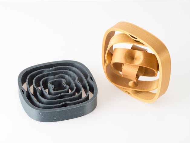

I’ve been playing with printed-in-place parts that break loose and have moving sections after printing (no assembly- printed as is). After calibrating the filament to get good dimensional accuracy, I’ve had some good success! I made a roller bearing wheel, a spring-loaded chip clip dinosaur, and a rotating spinner. All seem to work well! I love this printer.

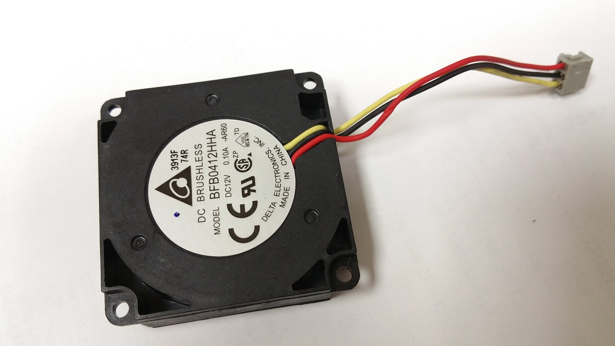

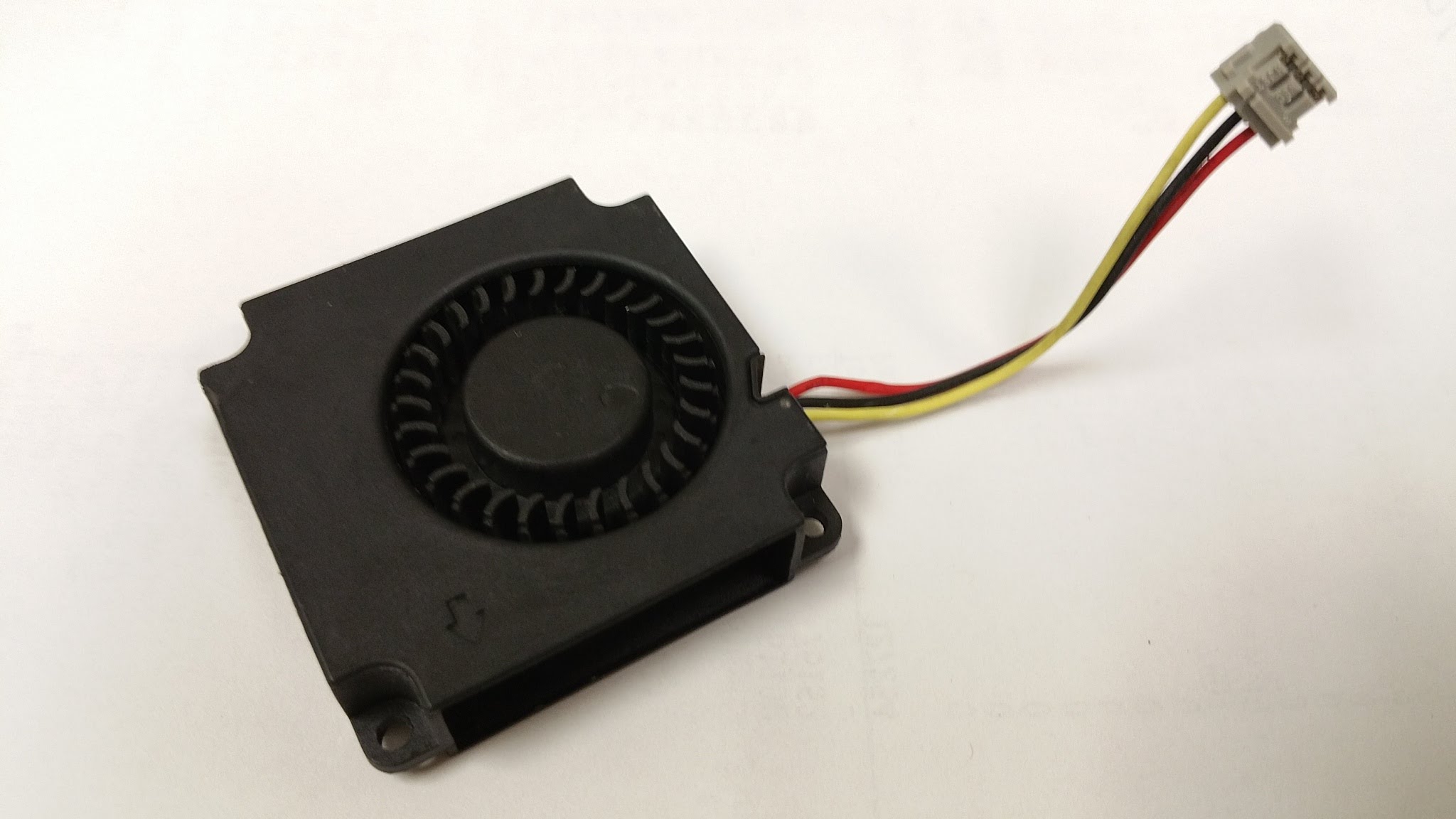

@Daniel_Jackman here’s a 12v blower fan I got out of a copy machine fuser from work…it is roughly the size of a stepper motor!
@Fook_INGSOC very nice. I have a nozzle on my part can that directs air just under the tip of my extruder. Works really well. My might have to design something similar for that fan. I bet that fan will run forever!
@Fook_INGSOC
I thought some of those fans, were stepper motors.
No?
@mark_warlick not stepper. Black=negative, red=positive & I believe yellow is tach feedback!
@Daniel_Jackman they run at least for 300,000 copies in the fuser of a kyocera copy machine!:joy::joy::joy: perfect size for a hotend! Very low mass!
