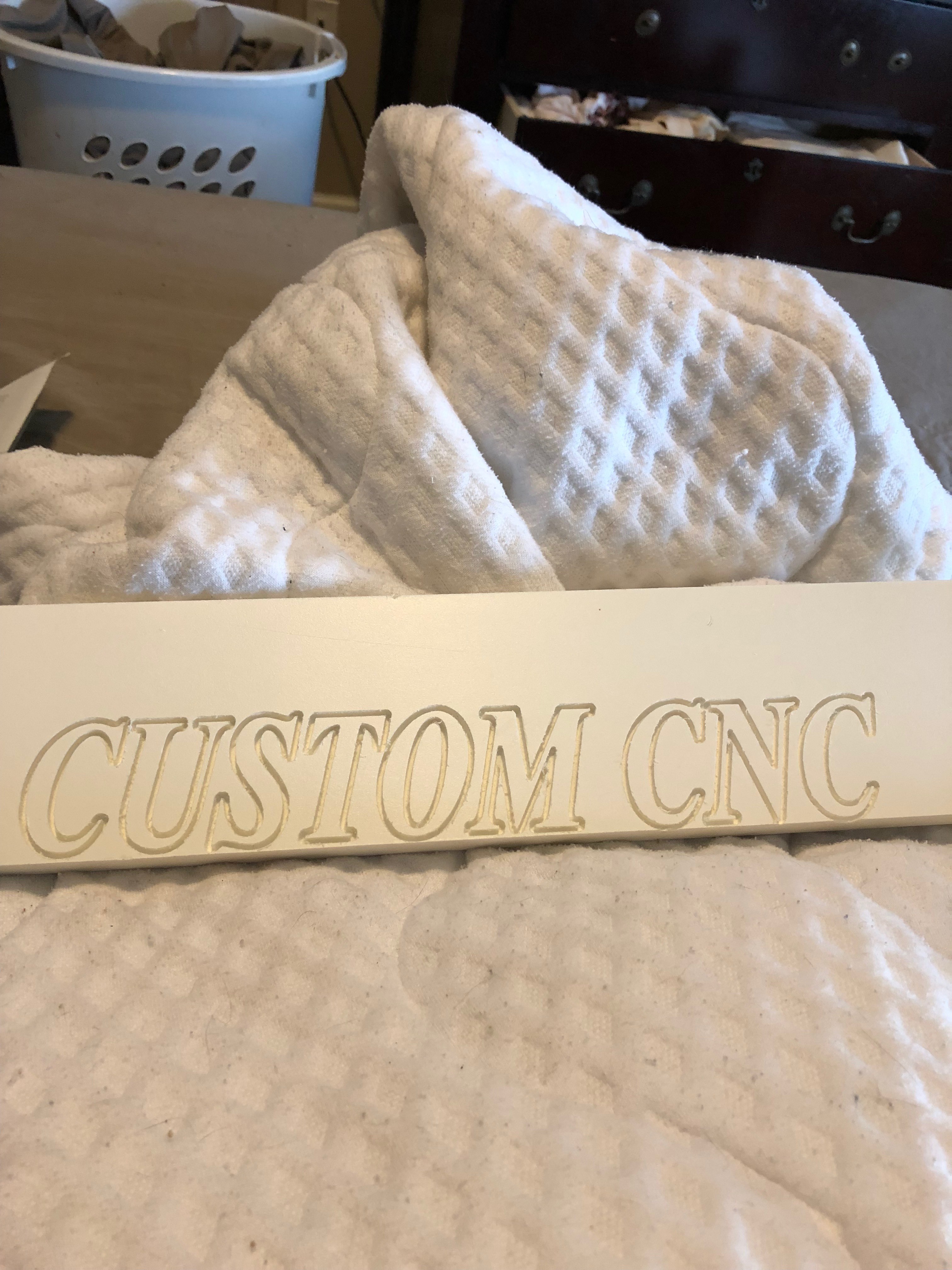

I’ve found PVC to be one of best materials to work with for doing signage. It cuts like soap.

Have you tried any single line engraving? You need special font files for that. What you’re showing here is an engraved outline font. That’s what most computer fonts are. Single line fonts are much rarer but give a different effect when you engrave them. An engraved single line font comes out more like how you’d imagine someone would carve letters.
I haven’t tried that yet. I’ll have to find the fonts. Thanks!
@George_Allen yeah I discovered single line fonts kind of by chance. Well, I wanted a carved letter look and you just can’t get that with an outlined font. Outlines are not strokes. So some digging into the matter lead me to single stroke fonts. Which are the rare Pepes of the digital font world. I think I’ve only ever managed to find a half a dozen of them or so. Because single line fonts don’t render too attractively on screens. That’s what most folks want to use digital fonts for. CNC is kind of an oddball activity. So it is catered to a lot less.
