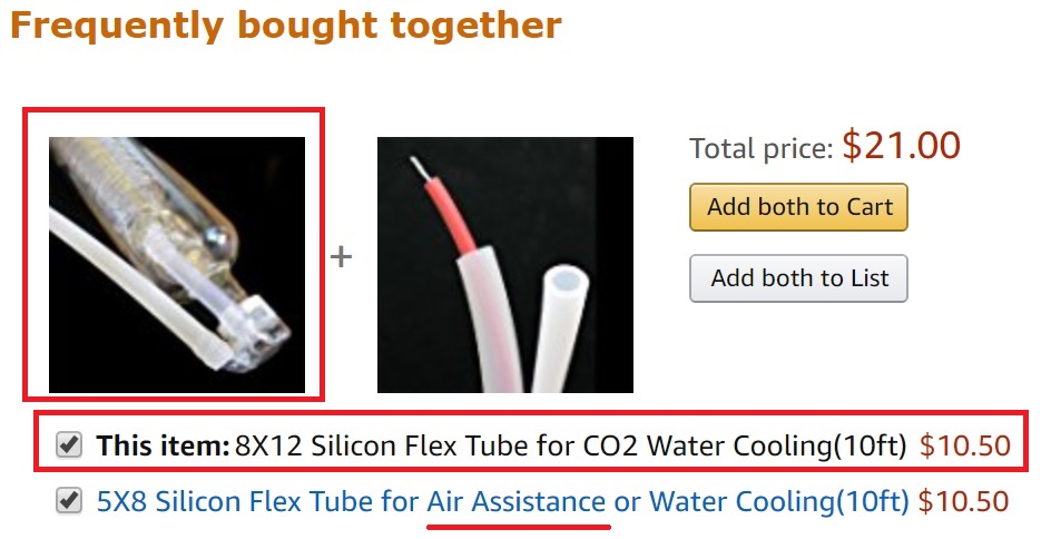

@Sebastian_C Agreed. As I noted above, I already bought 10 feet of silicone tubing from LightObject on their Amazon store:
James, Call them today (or monday morning) at 1-916-572-6080. You posted you got 8X12mm. That is the wrong size. You need 5X8mm for a K40.
@Steve_Clark I received it Jan. 17th. I’ll check the diameter soon (probably Sunday) and if it is incorrect, I think I still have time to return it via Amazon (I hope). Thanks.
@Steve_Clark Actually, I think you may be mistaken:
@SirGeekALot YOU ARE CORRECT … I was wrong… I should have double checked on my old invoice .
8X12 Silicon Flex Tube for CO2 Water Cooling
LSR-WTUBE8X12 $0.85 16 $13.60"
Actually, it looks like the new tubing is too large (I compared it to the existing tubing). Moot point though. I decided to just use the existing tubing and it is working fine. I’ve already done my test burns and aligned the beam. I just need to do a ramp test and make sure I’ve got the focus where it needs to be, then I’ll be ready to actually try cutting a real project!
