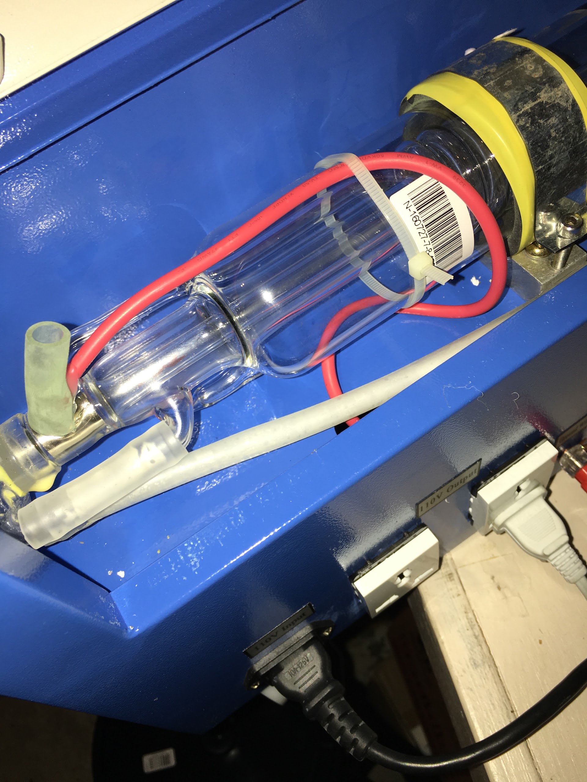

I’ve got the distilled water I need for the cooling system. But now I’m wondering about the white residue in the tubing that came with the K40 laser. Should I be concerned about it? Related question: it is in my garage and while it rarely snows here in the Seattle area, the temperatures can sometimes drop below freezing at night. Any suggestions to help mitigate freezing water destroying my laser tube? I know I cannot use anti-freeze. Would it be safe enough to blow compressed air through the tubing when I’m done to purge most of the water? How do you folks handle such situations?
You can try flushing the system a couple if times but personally I would get new tubing. I’ve seen where someone, in a similar situation to you, would keep the pump running and used a light bulb to keep the water above freezing. You could also probably use an aquarium heater with the pump running Just keep in mind to drain the tube if there is a power outage at the same time as below freezing temps. As long as most of the water is out then it should be fine.

The white stuff is as some have already pointed out probably lime / calcium carbonate from your hard tap water. It should go away with little acid (citric acid for preference). With higher temperature the precipitation will increase, so most fallout will be in/after the laser tube.

@Sebastian_C Good info, thanks! Regarding the white stuff, I have yet to run water through the system–the white stuff came with it. I’d also say they would have to be using some pretty damn hard water to make that much of it. So unless I got a heavily used laser tube (!) I think something else must be the reason for it.
In other related news, I have a brand-new 5 gallon bucket and lid from Home Depot, 5 gallons of distilled water, and some Tetra Algae control. I also have 10 feet of new silicon tubing from LightObject in case I feel brave enough to change the tubing. EDIT: Now I just need to find the time, which is to say probably not until after Valentine’s day. :frowning:
Random thought/question: could the white stuff be residue from silicone caulk or similar sealant? If so, then it would be firmly adhered to the tubing by now and is perhaps much ado about nothing, right? EDIT: I don’t think there are any large “chunks” that could clog things up if they detached from the tubing.
No white stuff is mostly likely mineral deposits due to the laser manufacturer using tap water during testing. We have seen videos of some of these Chinese places making tubes and it’s not pretty.
@Nedman Yikes. I wish I could say I was surprised. Any tips/gotchas on replacing the silicone tubing?
