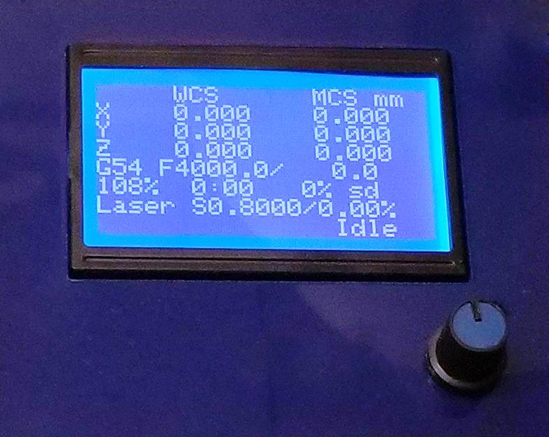

It’s a graphic LCD, useful for seeing status, jogging/ controlling the machine, and running jobs without having your computer tethered all the time.

@raykholo What do “WCS” and “MCS” mean in that image? (Also, while I’m sure I can find it, a direct link to the GLCD item for sale on your website might be more helpful than just the image of it).
World vs Machine coordinates. As long as you haven’t applied a G54 offset (complex CNC stuff) then they’re the same. I just pay attention to the left half
