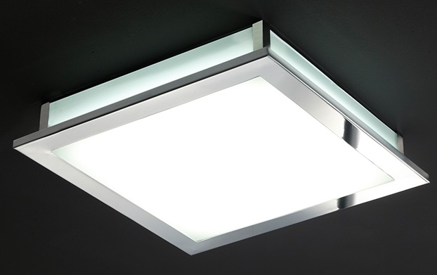

I want to build my own ceiling lamp with WS2812B LEDs (like the one
I want to build my own ceiling lamp with WS2812B LEDs (like the one in the picture).
Is there any rule of thumb to calculate how many LEDs I would need to get the brightness I want?
My current standard lamp has an OSRAM 15 Watt lamp with ~900 lumen according to the specs.
But it would be nice if my new lamp was brighter, of cause.
Any experiences or calculations you can point me to?
