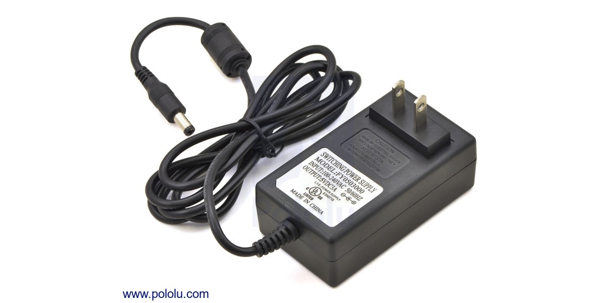

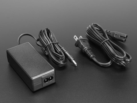

Pololu has usually great products
I should probably have said - Polulu/Adafruit/Any US supplier probably won’t fly - I live in SE Asia, the cost of shipping is extraorbitant, plus we are 220V.
But thanks, I think I will give a ‘laptop’ type supply and do what allanGEE suggested and run it hard for a few hours to give it the smell test.
