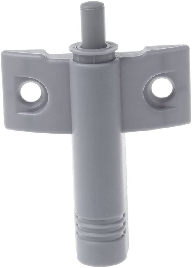

3
Would a drawer buffer do ?
They act as a simple stop but then slowly take up the last few mm on a damper.

4
@artag mmm I will take a look. That may keep it from slamming but not hold it open?

6
The drawer closer won’t hold it open, but doesn’t the lid tip back far enough to stay ? Although the gas supports are nicer, I think they’ll limit how far the lid will open, which might be a nuisance.

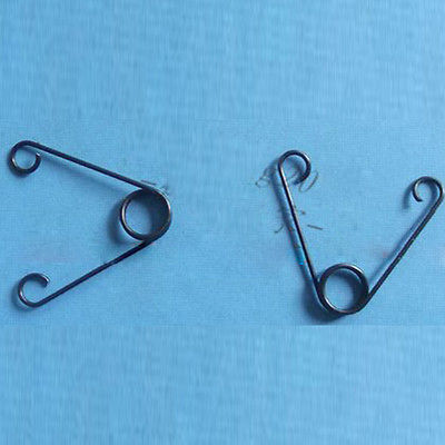

8
I haven’t installed any but how about torsion springs?
