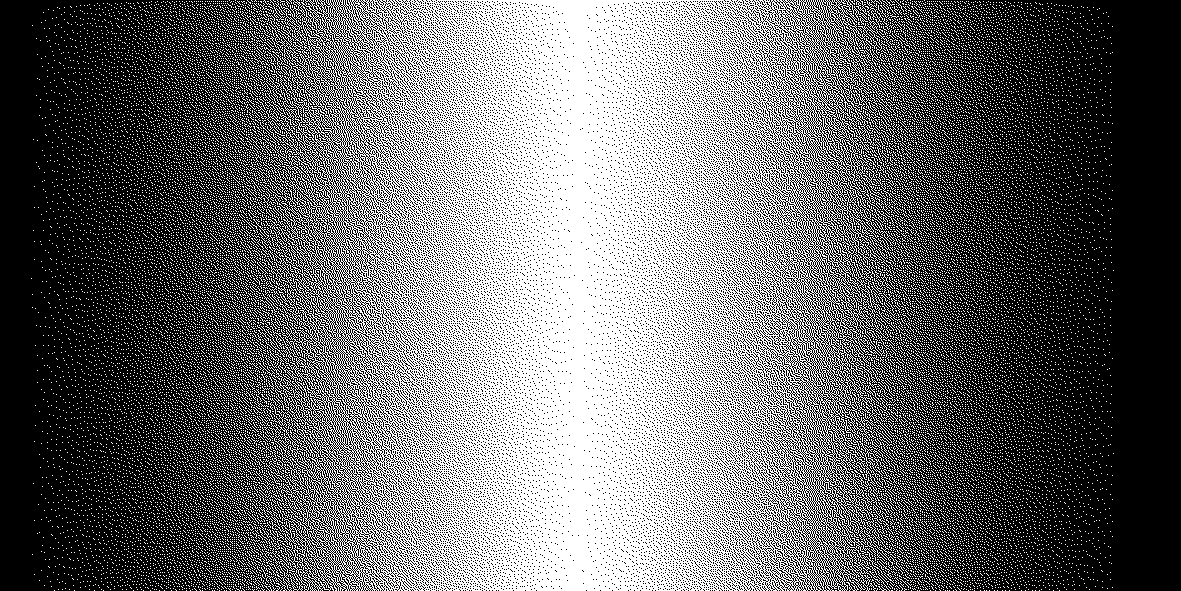

I’d suggest testing a gradient engrave bitmap, with the curve profile you want based on the scale of greys. May or may not work as well in practice as it theoretically should.
I have the basic controller that comes with the K40 but maybe this is the excuse I need to upgrade to a Cohesion3D. Iwill see if I can figure our how to do grey scale in CorelDraw
@Phillip_Meyer it’s not possible to do true gray scaling with the stock controller. What people do however is to use dithering to create a gray scale effect by varying the density of engraved dots. It maybe possible to do some profile engraving but it’s going to be a step profile where you have a series of engrave elements and you engrave sequentially with increasing power or slower speed.

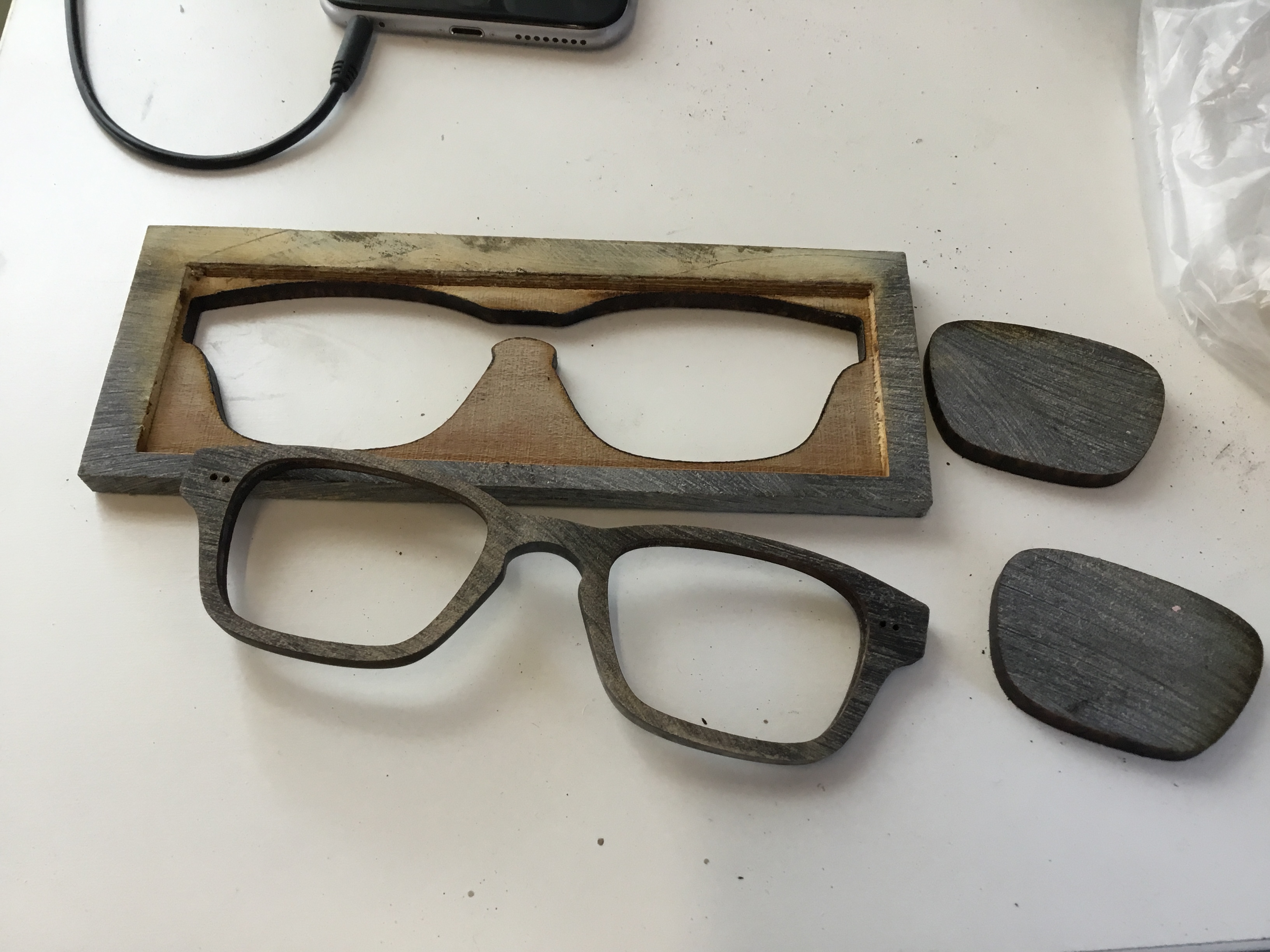

I managed to reduce thickness consistently using engraving but still need to experiment with a gradient pattern. I think it might be best to just get a better control board for the laser as I find CorelDraw so frustrating (not to mention the fact I have to keep rebooting my Mac to run windows)
@Phillip_Meyer That looks to be a great result. Did you engrave that whole depth into the material?
I totally agree on the frustrations with CorelDraw. It seems a very clunky interface & made it difficult to work with the laser for me (as last time I used CorelDraw was over a decade ago).
With controller upgrade you will be able to run natively in OSX, so that will be an added benefit for you as well as the improved performance/capability.
Hi, yes, engraving seemed to cut about .45mm deep so I ran 5 passes. I tried different size boxes first to try and give a graduated depression but the steps were very obvious (an about 0.5mm apart) so it would have required more sanding that manually filing the additional grooves. I have a cohesion3d board on order, hopefully that will give me more control.
