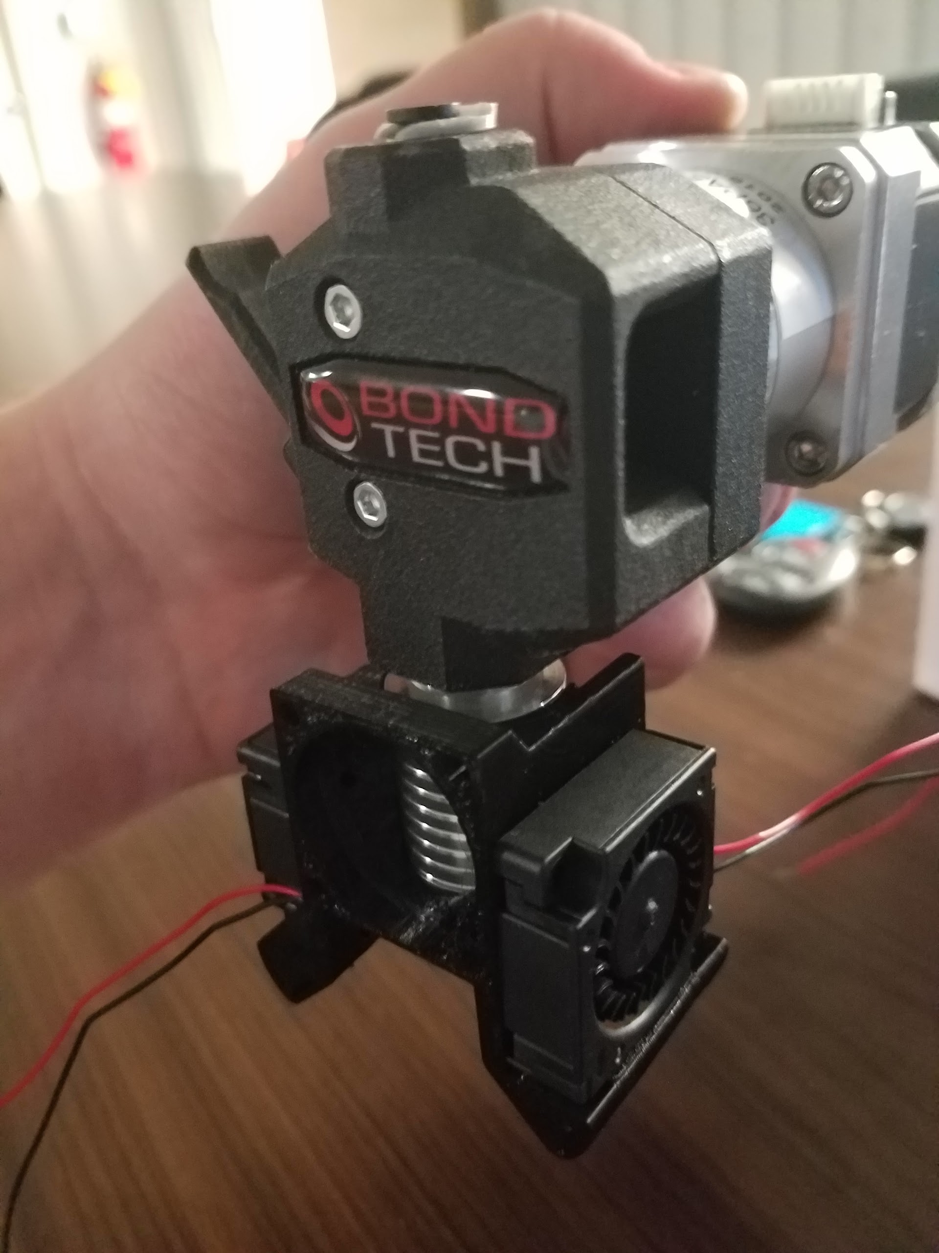

I wanted a small dual cooling fan set up for my dual extruders.
I wanted a small dual cooling fan set up for my dual extruders. This was the smallest design I could come up with. There are a few more small changes I want to make but so far this design works very good.
Link to the fans?
http://www.digikey.com/product-detail/en/delta-electronics/BFB0312HA-A116/603-1839-ND/5022815
Use an aquarium air pump to an airline, and you can vastly reduce the size of your on-hotend cooling solution
I did the same on very different printers and found it very, very better at cooling if the fans are mounted at an angle of 30°. https://scontent.ftxl1-1.fna.fbcdn.net/v/t1.0-0/p173x172/13895051_232108880518721_6350959604160813469_n.jpg?oh=d1f0d12eef1b4414e5514508c393371d&oe=581462BA
@Rene_Jurack That setup takes up too much space to work in my current situation. The plan is to extend the ducts down a little lower so they are closer to the tip. Right now the ducts are angled at 45 degree angles.
