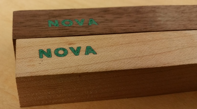

I wanted to show off my first test piece using the laser engraver.

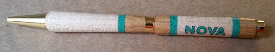

i purchased that laser engraver to do inlays in wood projects. In the example the word Nova was inlayed into the pen using the laser, Its about 5 X 23 mm in size.
I am using laserweb3 to get more control then i had on the Elekscam software.
Now that it was a success i will try more finer cursive writing and see how far i can push the tool.
@thomas_dillon you engraved a space in the block that was the negative of the word. Then you cut a positive and inserted that into the block. How deep was the engrave?
@Michael_Audette The blanks were test to check the burn settings. A few blanks i placed a inlay to see the color contrast. I have to find different settings for different type of wood.
I turn the pen into the proper shape, then laser engrave, then sand and finish the whole pen back on the lathe.
